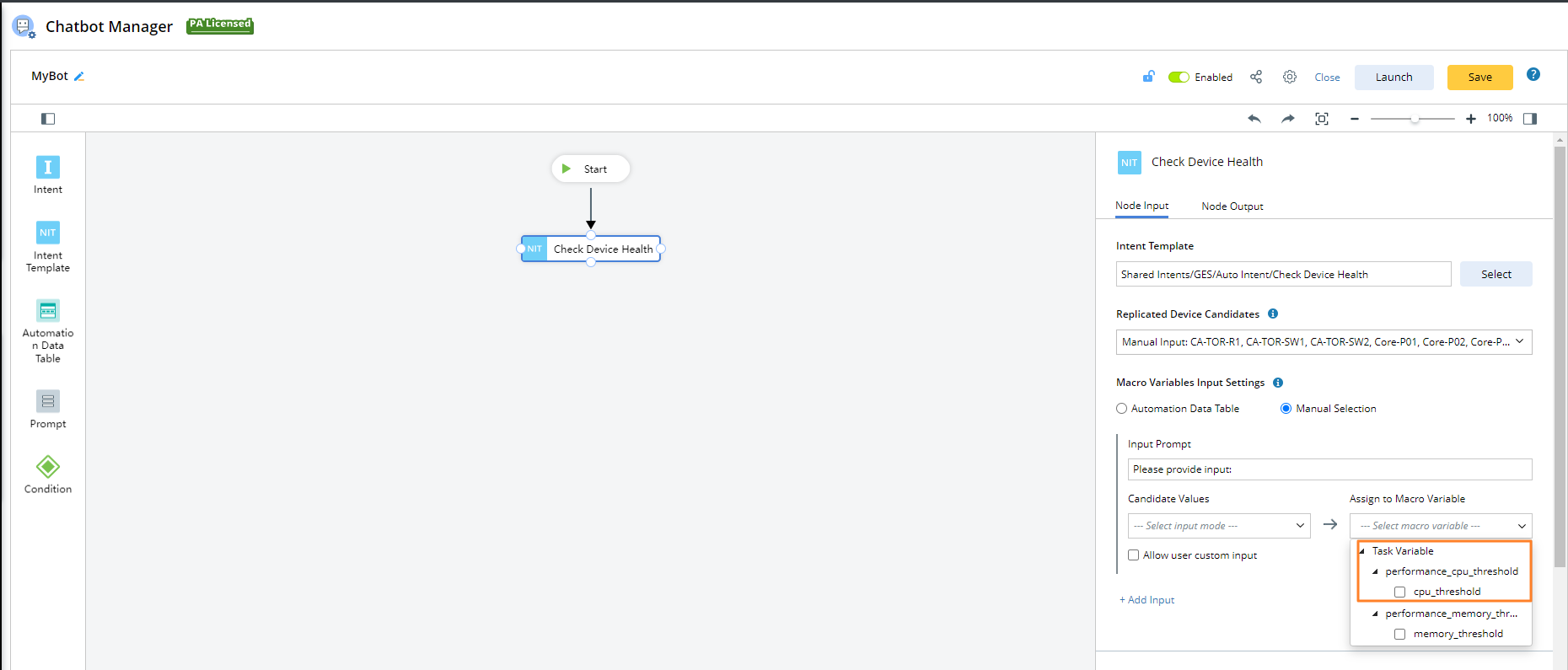

Bot
  • Remove the support for the intent macro variable.
  • Support task variable and its format is GroupName.VariableName.
