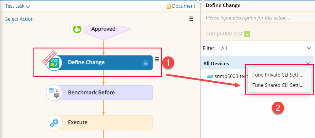

Before implementing the change, it is recommended to make the following preparations:
  • Tune Shared CLI Settings: click the Define Change node > drop-down list of All Devices > Tune Shared CLI Settings.
  • Tune Private CLI Settings: click the Define Change node > drop-down list of All Devices > Tune Private CLI Settings.
