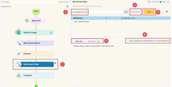

  1. Click the Benchmark After node.
  2. In the Benchmark After pane, click the   icon to customize devices and define the data type. The predefined devices, CLI commands, and data types are used by default.
  3. Click Run to benchmark data.
    Information Tip: If you select the Auto update all selected data in Current Baseline check box, the configuration files stored in the Current Baseline will be overwritten with the retrieved data.
  4. Click the Results tab and select a device to view its results.
  5. Click the Execution Log tab and select a device to view its logs.
