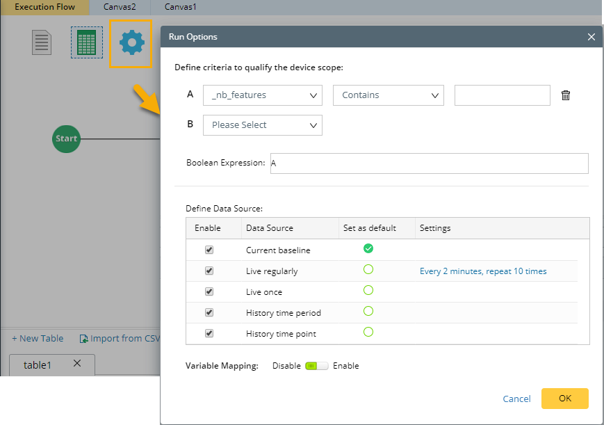

Defining Filter Criteria
  1. Click the icon in the Qapp Editor.
  2. Set condition A based on your needs:
    1. Select a device property from the property list.
      Information Tip: Whether a device property can be used as a condition for the advanced filter is configured in the Global Data Repository.
    2. Select a keyword from the operator list if a selected property has this option. The keywords include Contains, Does not contain, Matches, and Does not match.
    3. Specify the value of the property that you selected.
    4. Repeat the above three steps to set more conditions if required.
  3. Define the condition combination in the Boolean Expression field. A Boolean expression can have the following parts: filter criteria (A to Z), Boolean operator ("and", "or"), and Parentheses. For example, A and (B or C).
  4. Define the data source. You should enable the required data source and set one as the default source.
  5. Click OK.
