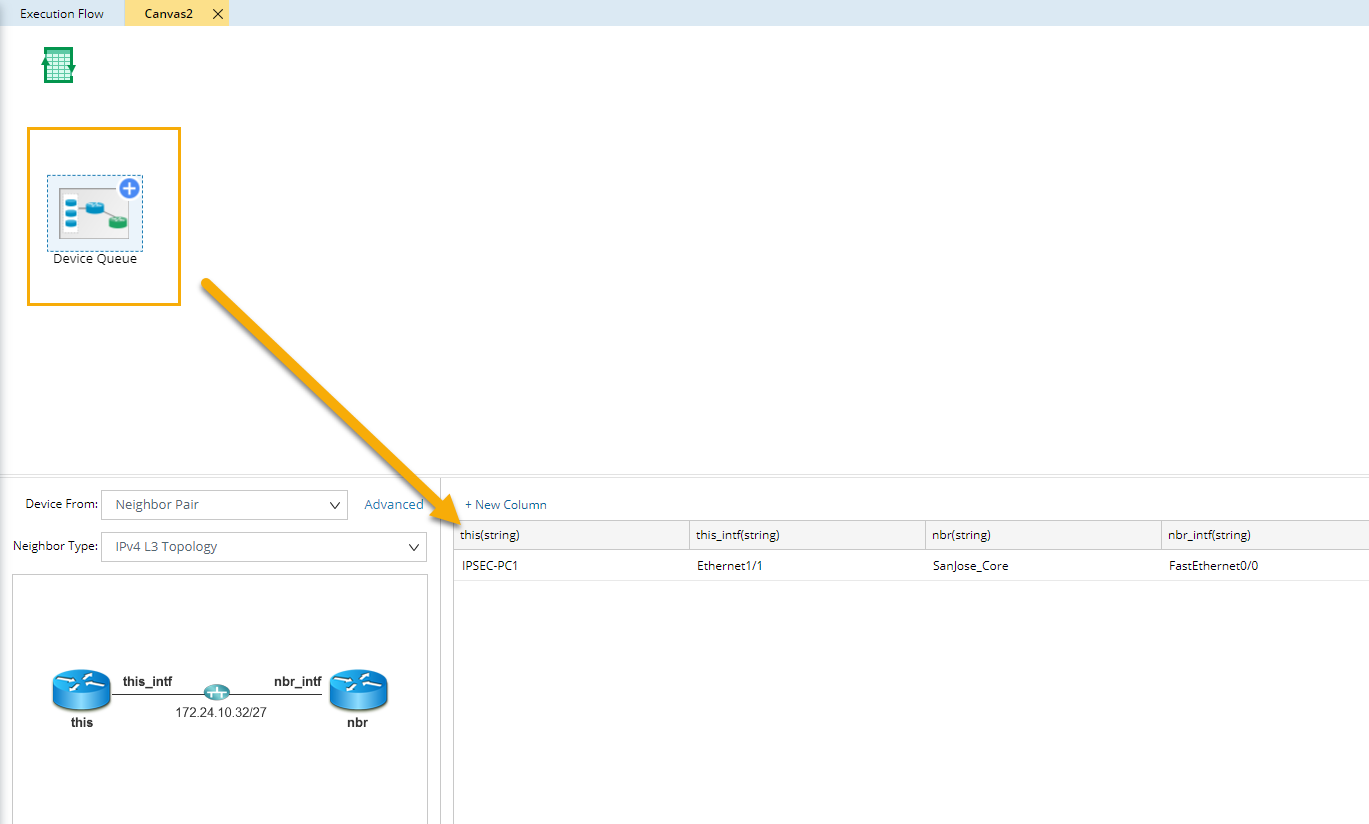

At this node, you can define the pattern to load input devices to the Device Queue:
  • Device — loads devices in a single device pattern and each device is an independent individual in the Device Queue.
  • Neighbor Pair — loads devices in pairs and each pair is a pair of neighbor devices. This Device Queue pattern is often used to compare the difference of a device and its neighbor, such as MTU and Duplex mismatch.
  • Path — loads devices in hop pattern. Each hop contains a device, the incoming interface and outgoing interface. If you select the Calculated Path option at the Start node, the Path option here is selected by default.
  • Table — load devices from a specified table and the pattern to build devices depends on the definition of the imported table. If you select the Table option at the Start node, the Table option here is selected by default. The specific table you can select is defined in the Global Table.

  • Neighbor Pair
    1. Click the drop-down menu of Device From and select Neighbor Pair.
    2. Specify the type of neighbor pairs (such as this and nbr in the device queue table) from the Neighbor Type drop-down list.
    3. IPV4/IPV6 L3 topology — includes each device and its Layer 3 neighbor devices.
    4. L2 topology — includes each device and its Layer 2 neighbor devices.
    5. Any combination — considers every two devices as neighbor pairs. If you select this option, you can skip the next step.
    6. Click Advanced to configure the following options based on your needs.
    7. logic to build device pair:
      Filter visible neighbors by map — select the neighbor pairs which are displayed on the map.
      Information Note: This option only takes effect when you run the Qapp from a map.
      Filter neighbors by group — select the neighbor pairs which are both in the group you selected in step 1).
      Information Note: If you select Auto in step 1), the group here refers to the device inputs you will add before running the Qapp.
      Order of devices is significant — the neighbor pairs are order-sensitive.
    8. Whether to include interface column:
      Do not include interfaces — default option.
      Include Interfaces — adds a new interface column (such as $_intf) in the device queue table at the right side.
