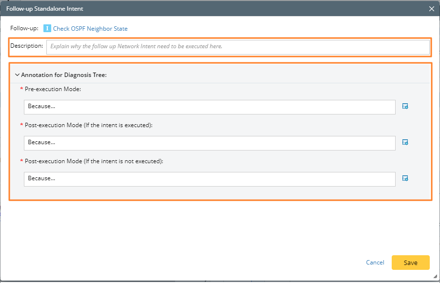

  1. Define more information for follow-up intents.
  • Define the Description to explain when this intent is executed and when this intent is not executed for the follow-up intent.
  • Define the Annotation for Diagnosis Tree to explain the situation corresponding to the intent execution. These messages will be displayed in the link of the diagnosis tree.
