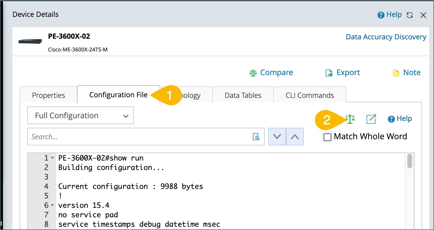

Compare a Single Data Type from Device Details Pane
Take the configuration file, for example:
  1. In the Device Details pane, select the Configuration File tab. The full configuration file of the device is displayed by default.
  2. Click the  icon under the Configuration File tab, and the comparison result displays directly.

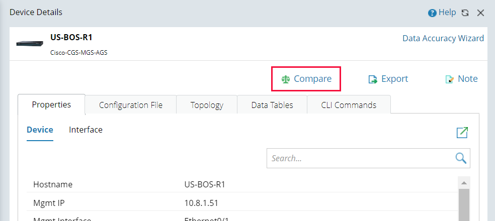

Compare All Data Types
From Device Details Pane, you are allowed to add a Compare Runbook Node to a Runbook to compare all data type
  1. In the Device Details pane, click  to add a Compare Runbook Node to the current Runbook or a new Runbook.
  1. For more information about Compare Node, see Comparing Network Data Changes.
