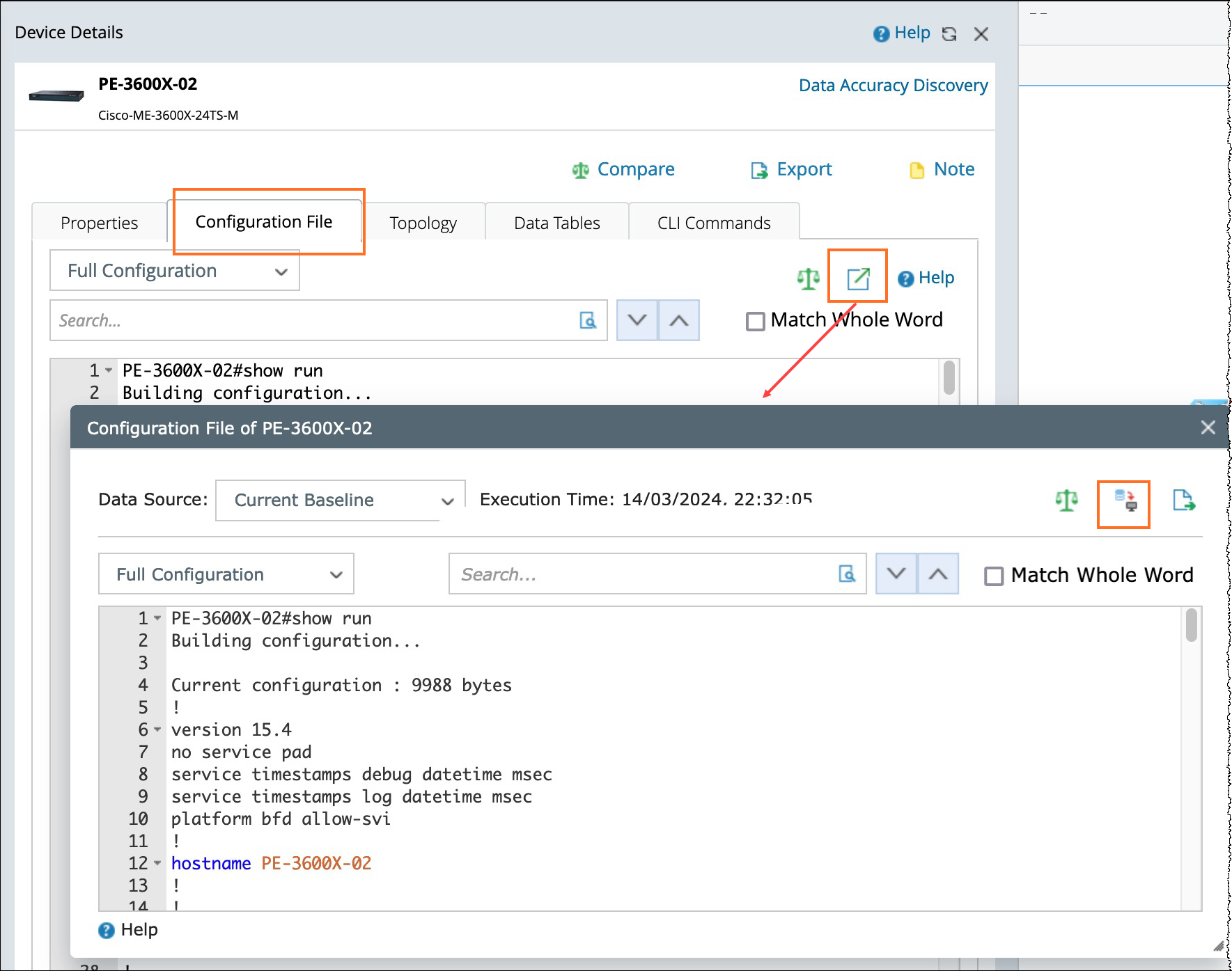

Retrieve Live Data for a Single Data Type
Take the configuration file, for example:
  1. In the Device Details pane, select the Configuration File tab.
  2. Click to open the configuration file in a pop-up dialog.
  3. Click the  icon to retrieve the configuration file from the live network. For more information, see Default Live.
