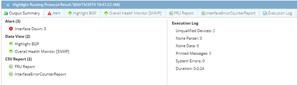

  • Output Summary
    The Output Summary tab provides a general view of Qapp outputs with statistics, highlighting the following information:
    • Generated output type and its count.
    • How many outputs each output type has.
    • Key execution information, including devices’ qualifications, variable mapping, etc., to provide a basic analysis for further troubleshooting.

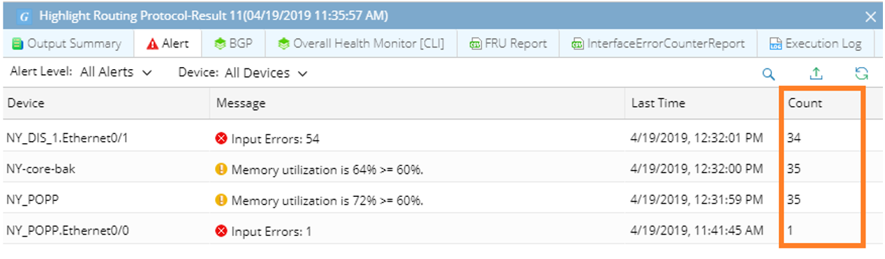

  • Alert
    The Alert Output tab shows the events, especially alerts, triggered at both the device and interface levels during a Qapp/Gapp execution. Duplicate alerts are merged into one entry, and the number in the Count column increases by 1.
    Event messages are categorized into four levels: Error, Warning, Information, and System. To filter messages by event level, you can click the icon to select target levels.
    Information Note: Displayed event levels might differ depending on the selected Run Mode of Qapps/Gapps. Only events in Error and Warning levels are duplicated in the Managing Events.

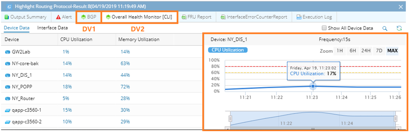

  • Data View
    The Data View Output tab shows the metrics of devices and interfaces generated when users run a Qapp/Gapp. For numerical metrics, users can view the historical data and trends of a specific metric over a period in a chart.

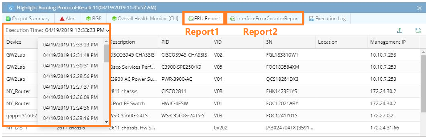

  • CSV Report
    The CSV Report Output tab shows the detailed asset information. For recurring Qapps, you can further locate the exact report instance via Qapp execution time, and then export it to your local disk.

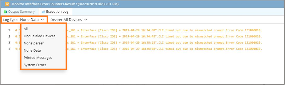

  • Execution Log
    The Execution Log tab shows the detailed execution logs with error codes for root cause analysis when you run a Qapp/Gapp. It provides filters to narrow down logs based on log types and devices.
    Information Tip: To auto-clean Qapp execution logs, refer to  Clean Domain Data for details.
