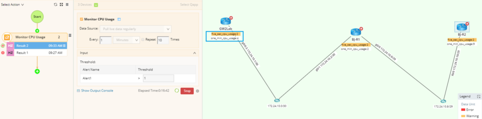

- Map the target devices.
- On the map page, right-click on the blank area and select Run Qapp from the drop-down menu.
- Select the Qapp you have created, and then click OK.
- In the opened Runbook pane, set the data source and threshold. In this case, select Pull live data regularly as the data source and set frequency as every 1 minute, which means that the system retrieves live data from devices and refreshes the corresponding values every 1 minute. For the demo purpose, modify the default threshold value to 1.
- Click Run in the Runbook pane. You can configure more settings such as data source, frequency, and a threshold before running a Qapp. See Run a Qapp for more details.
