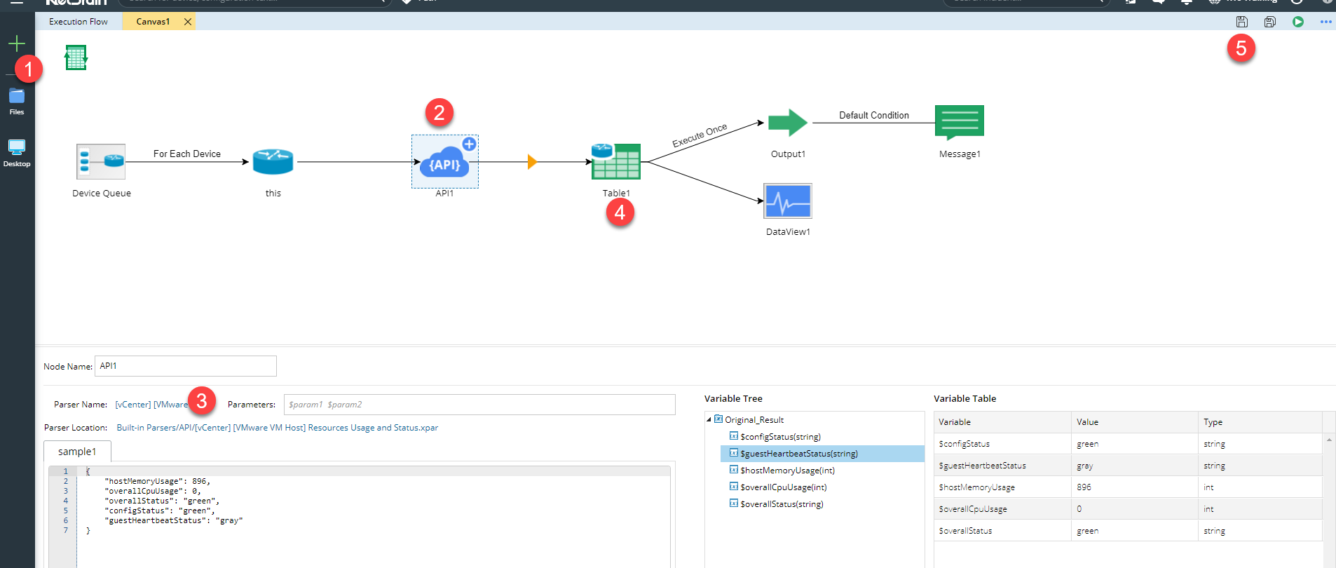

Create a Qapp
Proceed to the steps below to create a Qapp to reference the created API parser and define outputs to analyze the data.
  1. Click the icon from the taskbar and select New Qapp from the drop-down menu.
  2. Double-click the Canvas node to enter the Canvas editor.
  3. Select API at the Command node.
  4. Select the API Parser you have created.
  5. Click the icon, select the data and push into the Table node. Define the output, such as highlight. For more details about how to create a Qapp, see Creating a Qapp.
  6. Save the Qapp.
