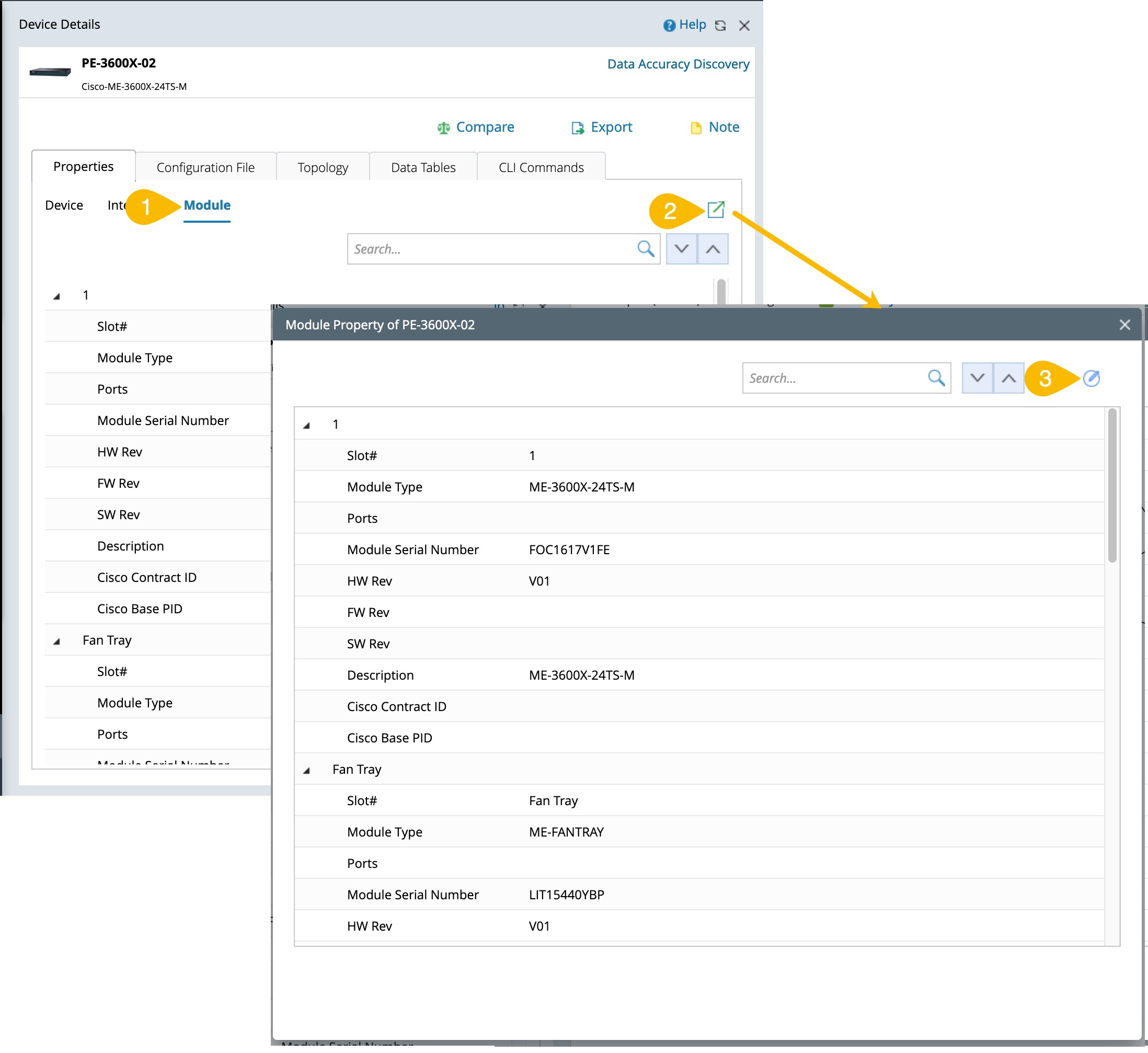

  1. In the Device Details pane, select Properties > Module. If a device does not have modules, the Module tab will not be displayed.
  2. Click the  icon to open the module properties in a pop-up dialog.
  3. Click the icon to enter the editing mode.

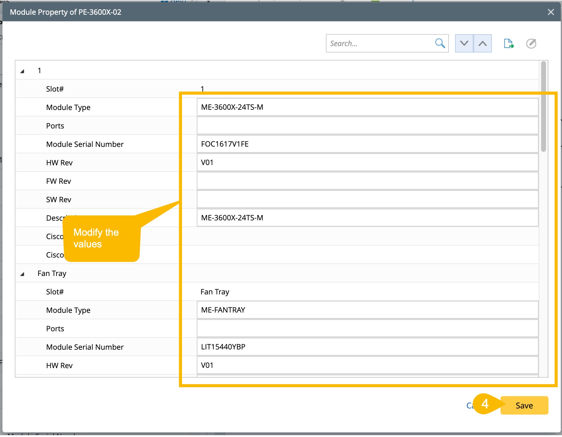

  4. Modify the values and click Save.
    Information Note: The values of some built-in module properties cannot be edited.
