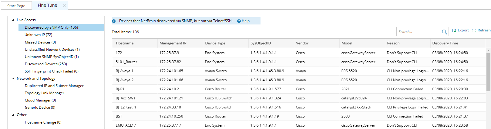

2.In the Domain Management page, click Fine Tune on the Start Page or select Operations >Fine Tune from the quick access toolbar.
3.In the Fine Tune tab, select Discovered by SNMP Only in the left pane. The devices discovered via SNMP only are listed.
4.Configure the Telnet/SSH credentials and tune live access on them.

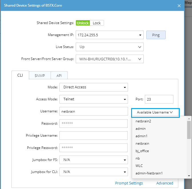

1)Right-click a device entry, and then select Shared Device Settings.
2)Configure the matched access mode and port number.
3)Click Available Username to select the correct username from the drop-down list.
4)Click Tune to check whether the current credentials can establish a connection between the Front Server and your live network.
a)If the connection works well, In the pop-up dialog, click Yes to save the current credentials and repeat step 1) to step 3) to solve other SNMP-only devices.
b)If the connection does not work, check the firewall rules and ACLs configured in your network.
2.In the Domain Management page, click Fine Tune on the Start Page or select Operations > Fine Tune from the quick access toolbar.

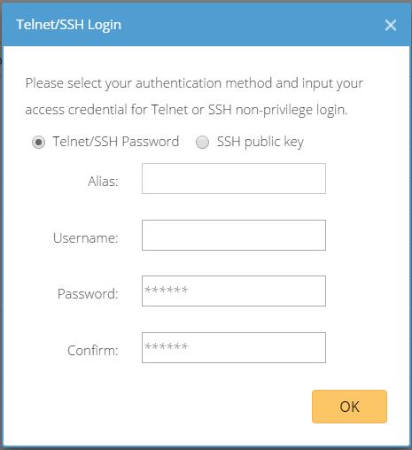

4.Select Operations > Discover Settings > Network Settings, and enter all the available credentials of the SNMP-only devices under the Telnet/SSH Login tab.
1)Click the Telnet/SSH Login tab.
2)Click Add. The following dialog box prompts.
3)Select the authentication method and enter the access credentials. Click OK.
4)Repeat step 2) to step 3) to add more entries.
