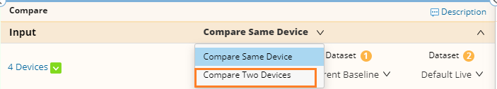

1.On the target map page, right-click on the blank area and select Compare. The Compare action node is expanded in a runbook.
By default, the Compare Same Device option is selected.
2.In the Compare pane, click the icon next to the Compare Same Device option, and select the Compare Two Devices option.
