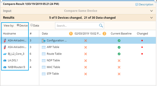

Browsing Results of Comparing the Same Device
Select either of the following two ways to view comparison result in detail.

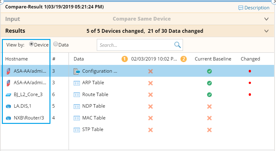

View by Device
View by Data
View by Device
This view shows data changes that have occurred on each device.
Example 1: View the changes of the configuration file of a device.
1.Select a device in the Hostname column. The # Changes column shows the total count of data changes on the selected device.
2.Select Configuration File in the Data column to view the change details.

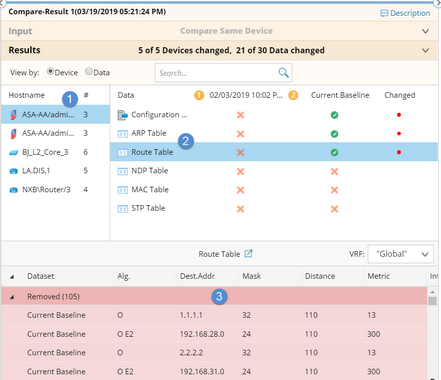

Example 2: View the changes of the route table of a device.
2.In the Data column, select Route Table to view routing changes.
Note: The comparison results for the same device and data type may be different if you swap the Dataset 2 and Dataset 1 during the comparison, because the Comparison feature takes Dataset 2 as a reference and uses the Dataset 1 to compare with it. For example, a comparison result shows that a route entry has been added, but it will show removed when you swap the two data sets.

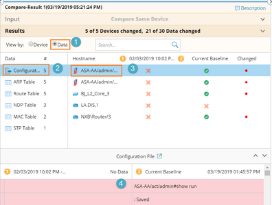

View by Data
This view shows the devices that have changes in detail.
Example: View the devices that have configuration files changed and select a device to view change details.
1.Select Configuration File in the Data column.
2.Select a device in the Hostname column to view change details about the configuration file of the device.

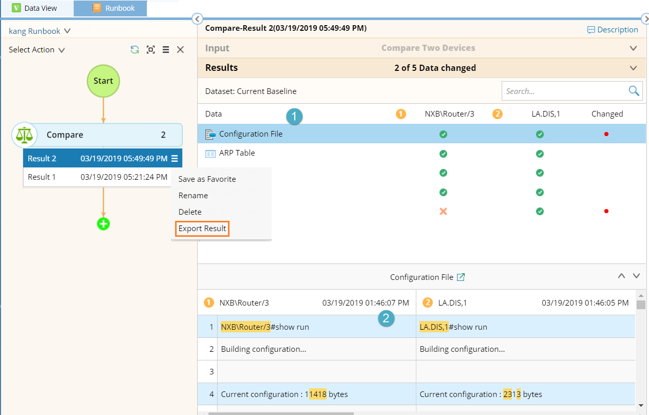

Browsing Results of Comparing Two Devices
1.Select a data type in the comparison result.
2.View the detailed differences.
Note: Comparison results may vary if you swap the positions for Device 2 and Device 1 during the comparison, because the Compare feature takes Device 2 as a reference and uses Device 1 to compare with it. For example, if the comparison result shows newly added route entries, when you swap the two device positions, removed items will be shown.
Note: No matter the comparison result for table data is removed or added, devices that currently own that data are always displayed.
Tip: You can click the icon in the Result area and select Export Result to export the comparison result.

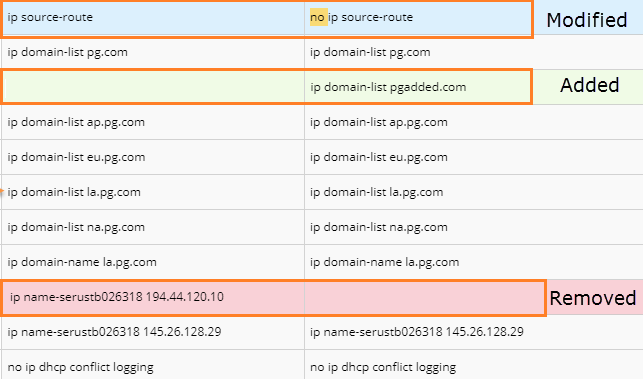

Change Types
The identified changes in comparison results are categorized as follows:
Category
Description
Added
The data only exists in the second data source or time period.
Modified
The data exists in both the first and the second data source or time period but has changes.
Removed
The data only exists in the first data source or time period.
Equal
The data exists in both the first and the second data source or time period, and no changes occur.
