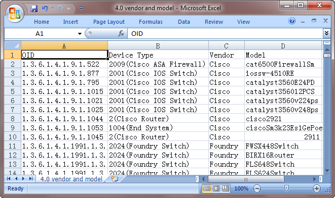

3.Use either way to add new entries in the table list.
1)Click Add at the upper-left corner of the table. A new dialog box prompts. 2)Enter the required information, such as OID, device type, vendor, and model. You can select the Auto Update check box to synchronize the data with NetBrain Application Servers. Tip: To add an unclassified device in the Domain Manager, copy the sysObjectID and paste it in the OID field. 3)Click Add. |
1)Create a .csv file in your local folder. For example: 2)Click Import at the upper-left corner of the table. 3)Select the .csv file you create and click Open. |
