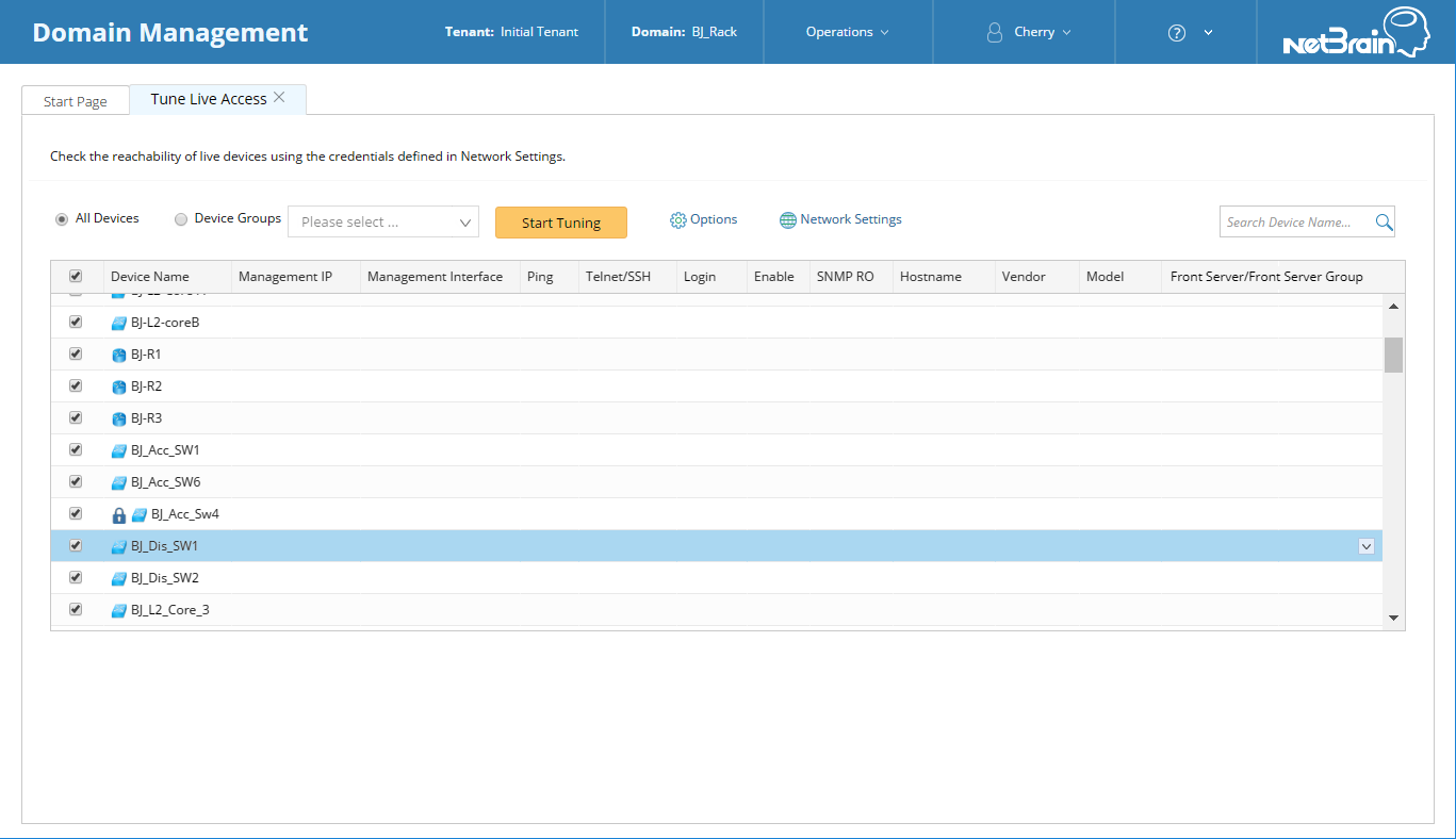

1.Log into Domain Management page.In the Domain Management page, select Operations > Domain Maintenance > Tune Live Access from the quick access toolbar. The Tune Live Access tab opens with all devices in the domain listed.

2.Select devices to tune the live settings. By default, all devices in the domain are selected. You can select devices by device group.
3.To view or change the tuning mode and access method, click Options. See Tuning Options for more details.
Tip: To specify Front Server, server jumpbox, and credentials to use in the tuning process, click Network Settings.
4.Click Start Tuning.

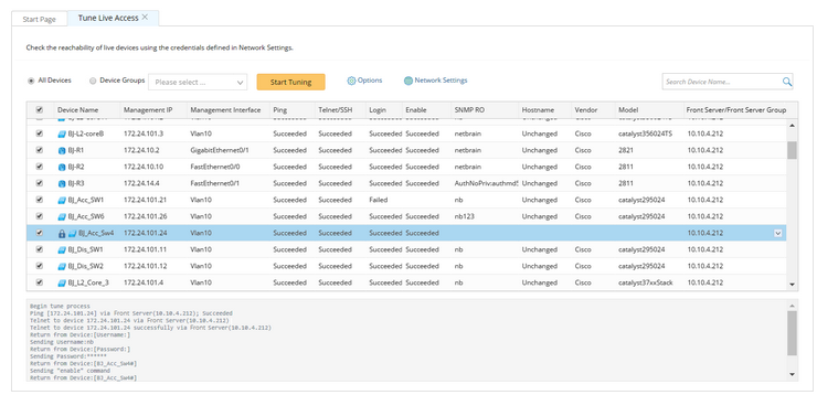

5.When the tuning process is completed, a notification message is displayed. Click OK.

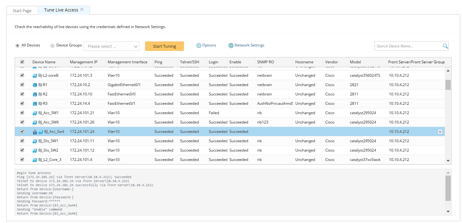

After that, you can click a device entry in the table to view the detailed log of the tuning process.
Note: If the system fails to access some devices with the Auto Set Device Settings option selected in the tuning options, you need to check the related credentials in the Network Settings.
Note: If you repeat the tuning process, the system will retrieve data for only devices with failure records by default. To repeat the tuning process for other devices, clear the current live access result via the right-click menu.
