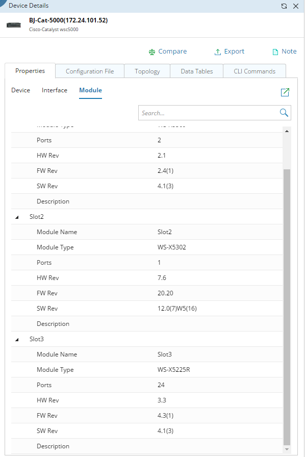

Both built-in and customized module properties are stored in the Global Data Repository. You can browse, modify, and export the values of module properties from the Device Details pane.
Modifying Module Property in Device Details Pane
1.In the Device Details pane, select Properties > Module. If a device does not have modules, then the Module tab will not be displayed.
2.Click the icon to open the module properties in a pop-up dialog.
3.Click the icon to enter the editing mode, modify the values and click Save.
Note: The values of some built-in module properties cannot be edited.
To export the properties to a CSV file, click the icon.
