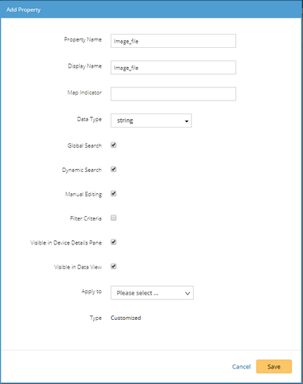

3.On the Device Properties tab, right-click the All Device Properties root node to select Add Property.
4.Specify the attributes of the new property. See Property Attributes for more details.
Note: To specify a value for the property in the Device Details pane, make sure both the Manual Editing and Visible in Device Details Pane attributes are enabled.
5.Click Save.
