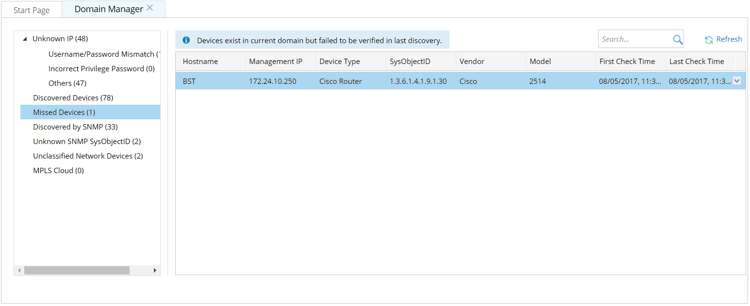

Decommissioned (Missed) Devices refer to the devices that are in the current domain but cannot be found in the last discovery. After the discovery, you can check whether there are any decommissioned devices in the Domain Manager.
To resolve decommissioned devices, complete the following steps:
1.Log into Domain Management Page.
2.In the Domain Management page, select Operations > Domain Manager from the quick access toolbar.
3.In the Domain Manager, click Missed Devices in the left pane. All missed devices in the last discovery are listed.
4.Select the devices, right-click them and select Discover Selected Device(s).
5.On the Discover tab, rediscover the decommissioned devices to verify whether they can be discovered.

If these devices are rediscovered successfully, they will be automatically moved from the Missed Devices category to the Discovered Devices category. Otherwise, you can manually remove them from your domain by right-clicking them and selecting Remove from Domain from the drop-down menu.
▪Context Menu in Domain Manager
