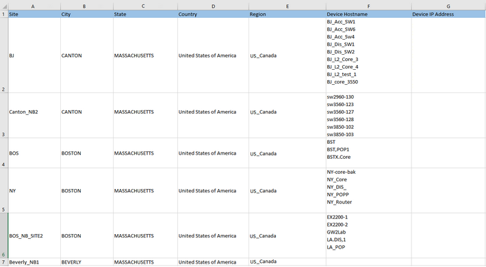

1.Prepare a spreadsheet with the table headers organized as follows to set the site hierarchy. Here is an example:
Site Name (Office)\City\State\Country\Region\Device Hostname
Note: Only the .csv, .xls, and .xlsx format files are supported. You can add more column headers or leave some columns blank based on your network distribution.
Note: The site name cannot contain any special characters, such as \ / : * ? " < > | . $
Note: The values in the Device Hostname column must be the same as those in the domain so that the devices can be identified and added to the corresponding leaf sites.
Note: The value in the Device IP Address column will be set as the criteria to search for site members. Only one IP address is supported in each row. You can leave it blank if not required.

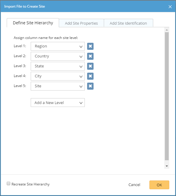

4.In the Site Manager, click Import from File, and then select the prepared file and click Open.
5.Configure the following settings.
1)On the Define Site Hierarchy tab, select table headers for each level to define the site hierarchy. By default, five levels are provided, and you can add more levels. In this example, you can define the site hierarchy as follows:
Tip: Level 1 is the top hierarchical node for each site. The sites that have the same parent table header will be treated as sibling sites. For the sites of which parent table header is null, will be treated as parent sites.

4)To delete all existing site hierarchy, select the Recreate Site Hierarchy check box. If left unchecked, the system will merge these sites.

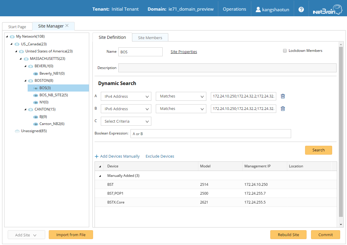

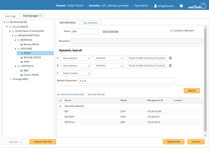

6.Click OK. The site nodes are created in the site tree. You can further add more devices to leaf sites. See Adding Devices into Leaf Sites for more details.
7.Click Rebuild Site to rebuild the site topology. The Site Member tab opens automatically, listing the device members in the currently selected site.
8.Click Commit to commit the site changes.
