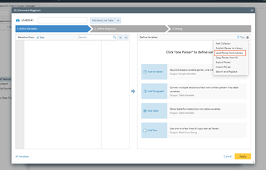

Parser Discovery Window will only show up when you need to select a Parser or load a Parser in NetBrain Automation Functions:
From Network Intent:
From Open Driver:

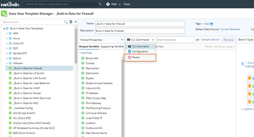

From Data View Template:

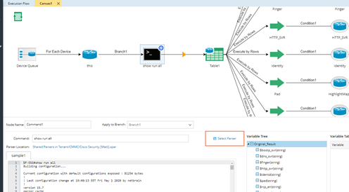

From Qapp:

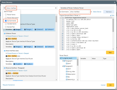

Searching for a Parser
By default, you can search parsers by :
parser name
parser description
CLI command
variable name

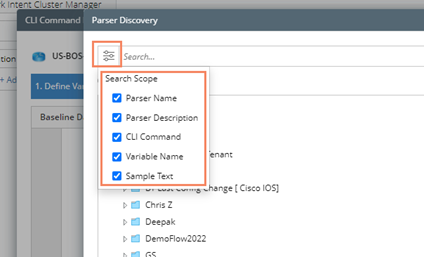

sample text
You can also modify the Search Scope by checking or unchecking some boxes to make it more effective:

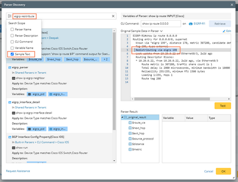

Search for a Configuration Parser:
If you want to search for a configuration parser, you can set Sample Data (Text) as the search scope, and type keywords in the configuration file (e.g. eigrp resitribute ) to find your parser.

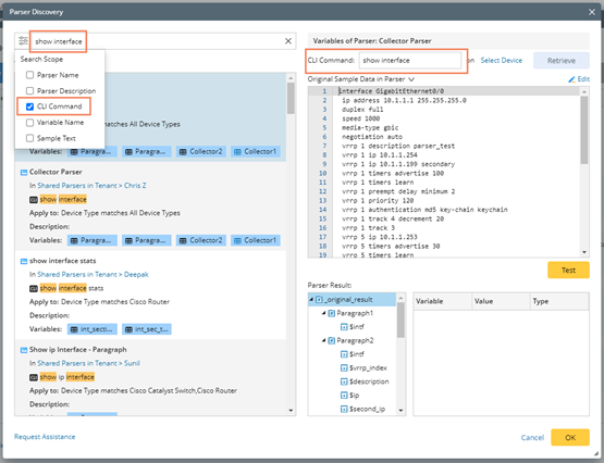

Search for a CLI Parser:
If you want to search for a CLI command parser, you can set the CLI command as search scope, and type keywords in the CLI command (e.g., show interface) to find your parser.
