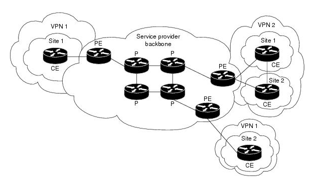

Here is a sample of MPLS VPN network. It includes the following types of elements:
▪Customer Edge (CE) — routers at the customer premises that is connected to the provider edge of a service provider IP/MPLS network. CE peers with the provider edge (PE) and exchanges routes with the corresponding VRF inside the provider edge (PE).
▪Provider Edge (PE) — routers in the provider's network that is connected to the customer edge (CE) routers located at customer sites. PE routers support VPN and MPLS label functionality. Within a single VPN, pairs of PE routers are connected through a virtual tunnel, typically a label-switched path (LSP).
▪Provider (P) — provider routers within the core of the provider's network are not connected to any routers at a customer site but are part of the tunnel between pairs of PE routers. Provider routers support LSP functionality as part of the tunnel support, but do not support VPN functionality.

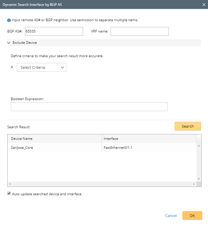

4)Add MPLS edge devices to the MPLS Cloud by either of the following ways:
1)Click Dynamic Search Interface. 2)In the drop-down list, select By BGP AS (autonomous system) to add edge devices and interfaces based on BGP AS number and VRF. Tip: You can also select By Advanced Search in the pop-up dialog and use the Advanced Search function to find the edge devices and interfaces. 3)Enter BGP AS number and VRF name. Tip: VRF is used to establish the correct connections if some devices have duplicated IP addresses. You can enter multiple VRF names and use semicolons (;) to separate them. Interfaces that have the matched VRF names will be searched out. If you don't want to use the VRF name as a condition to filter interfaces, left it empty; if you want to search interfaces without VRF configured, enter 'global' (single quotes must be included). Tip: Through a specified BGP AS number, a device that meets all the following conditions will be added as a CE device: - The devices not only configured with EBGP Neighbor but also pointing to the defined AS number. - The non-loopback interface in the same network segment with EBGP Neighbor IP configured on the device. - The neighbor IP of CE devices does not exist in the domain. 4)Click Search. Tip: To exclude specific devices from the search results, you can define more filter criteria. Tip: To automatically synchronize the list of edge devices and interfaces with your live network, you can select the Auto update searched device and interface check box. 5)Review the search result, click OK. |

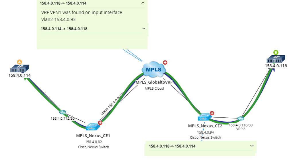

After building the NCT and topology, you can calculate paths across MPLS clouds. During the path calculation, the system looks up the virtual routing table to find the correct inbound and outbound traffic interfaces of the MPLS cloud.
