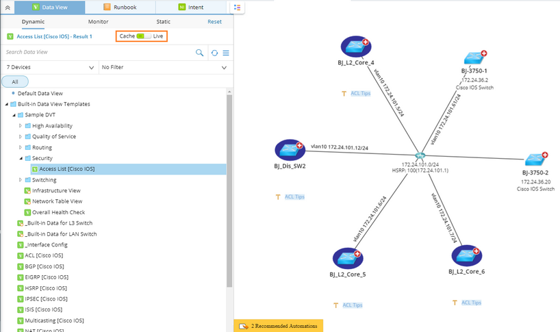

Dynamic Data View
Dynamic Data View refers to those data views generated by applying Data View Templates (DVT) to a map page. See Applying a Dynamic Data View to View Alert and Drill Down for more details.
Tip: The indicates the data view template has been scheduled to run; the icon indicates the data view template hasn't been scheduled to run.
Tip: To pull live data in a data view, you can toggle the switch from Cache to Live.

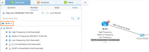

Monitor Data View
Monitor Data View refers to data views generated by applying the flash probes and variables enabled by the devices on the current map. You can get the latest flash probe and variable results by clicking the icon.

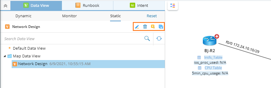

Map Data View
Map Data View refers to a data view that is saved within a map, and can only be visible in the current map. It is generated by saving a dynamic/static data view.
To view Map Data Vies, navigate to the Static pane.
Tip: You can hover over the above highlighted area and click the corresponding icons to edit, delete, manage, and save as the map data view after the data view is applied.

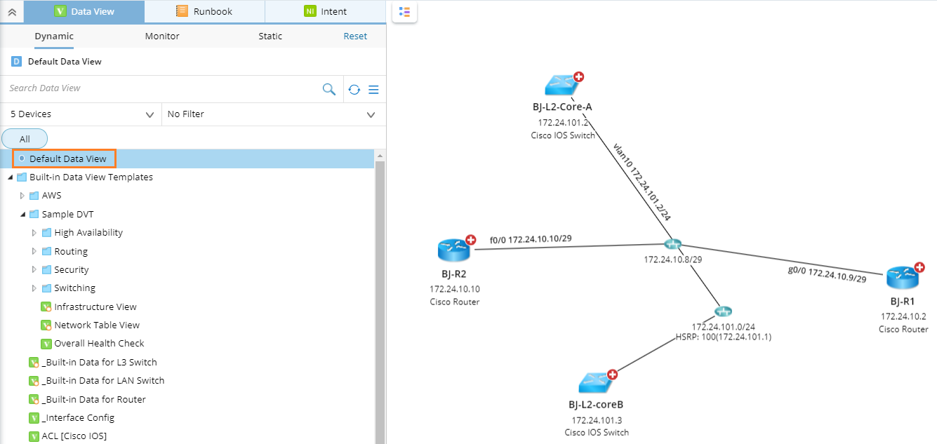

Default Data View

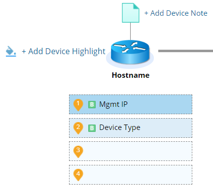

By default, devices on each map page are displayed in the default data view.
Tip: To update a default data view with the latest data saved in the database, you can configure through a scheduled benchmark task. See Updating Default Data View for more details.
Default Data Units on Traditional Device Positions
Position
Device Data Unit
Position1
Management IP
Position2
Device Type
Position3
NULL
Position4
NULL
See the picture below to understand the device position.
Note: If the value of a data unit is null, it will not be displayed in the specified position.
