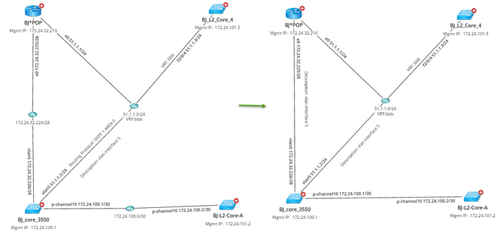

Hide media connected with two topology links only
Hides the media connected with only two links.

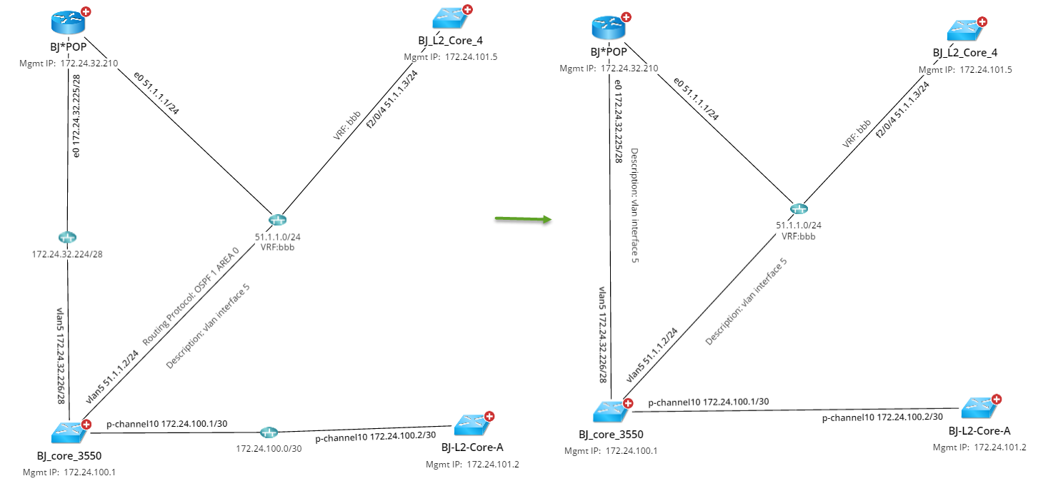

Auto Link Settings
Default Auto Link:
IPv4 L3 Topology
IPv6 L3 Topology
L2 Topology
L3 VPN Tunnel
L2 Overlay Topology
See Topology Type for details.
Link Option Between Two Devices:
Exclude Management Interface
Exclude management links from map while using the auto-link function.
Note: This option has dependency with the execution of the built-in plugin Identify Management Interfaces through the basic system benchmark task.

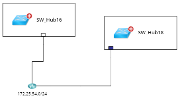

Device View on Expanded Style
One device type that is suitable for Layer 2 topology. You can point to a port or click a link to view its detailed information.

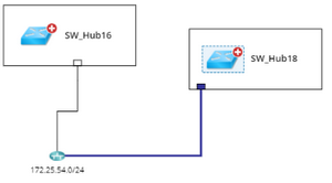

Interface Highlight Mode
Highlight Link & Port
Highlight both link and port.
Only Highlight Link
Highlight link.
Only Highlight Port
Highlight port.
