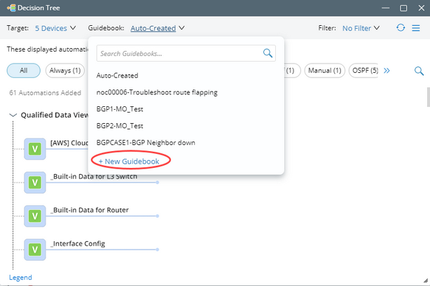

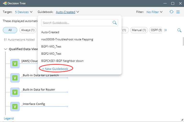

You can create a Guidebook via Decision Tree.
To create a Guidebook, define the following settings:
2.Select Data View Template or Define Hypothesis to Associate with Runbook Template and Network Intent
Note:For the newly created Guidebook to be displayed in Decision Tree, the followings must be fulfilled:
a)The system completes the qualification.
b)After the qualification, you need to manually refresh the current Decision Tree, or re-open the Decision Tree.

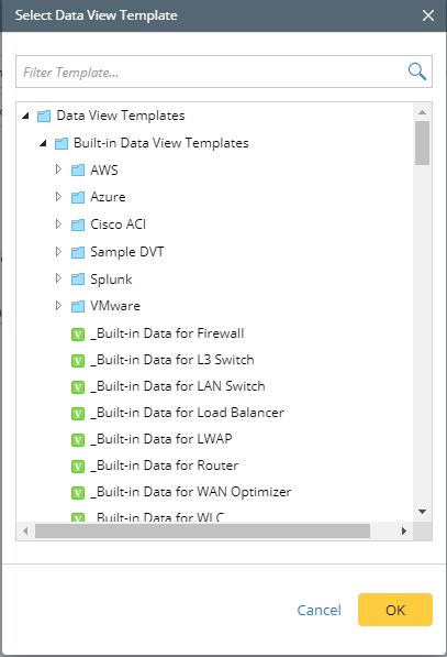

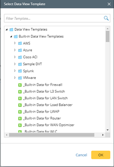

1.Click +Add Automation and select Add Data View Template.
2.In the Select Data View Template interface, select the desired Data View Template and click OK.
Note: The available Data View Templates may vary from user to user.

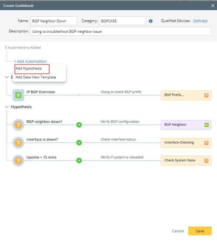

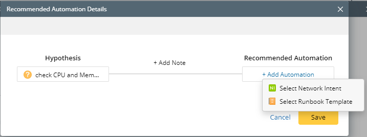

Follow these steps to define hypothesis and to associate it with Runbook Template and Network Intent:
2.Associate the Runbook Template and/or Network Intent with the Hypothesis

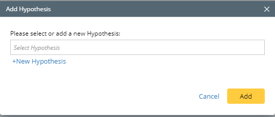

1)Click +Add Automation>Add Hypothesis.
2)In the Add Hypothesis window, you can select an existing Hypothesis(from other Guidebooks) or create a new one.
Tip: Once the Hypothesis is selected, the Runbook Template(s) and Network Intent(s) associated with this Hypothesis in other Guidebooks will be displayed.You can decide whether to add the Runbook Template(s)/Network Intent(s) into the current Guidebook.

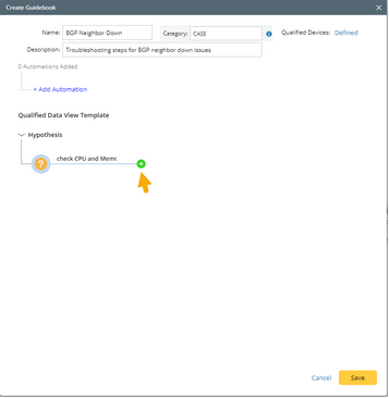

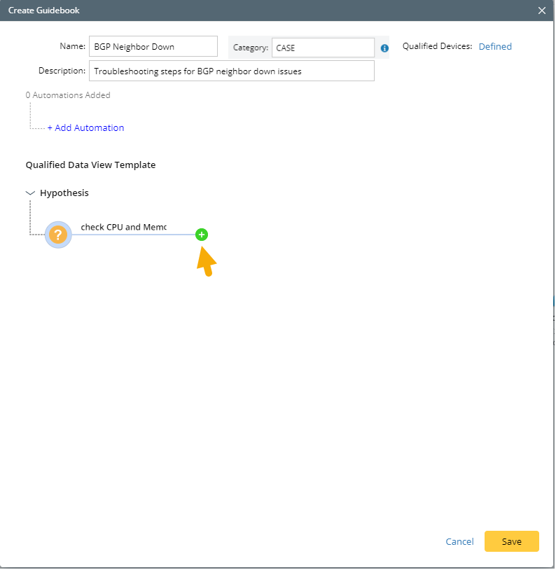

1)After the Hypothesis is added to the Guidebook, click
2)In the Recommended Automation Details window, click +Add Automation, to select Network Intent or Runbook Template.
3)Click +Add Note to define the note.
Note: The note will be displayed above the connecting line
