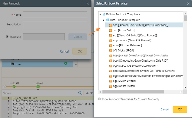

Three ways of the device qualifications defined in the template will be automatically applied to refine target devices on the current map:
When you create a runbook on a map by applying a runbook template:
When you add runbook template in the runbook:
Add runbook template to runbook in the recommended automation with the data view template, decision tree, and network intent:
