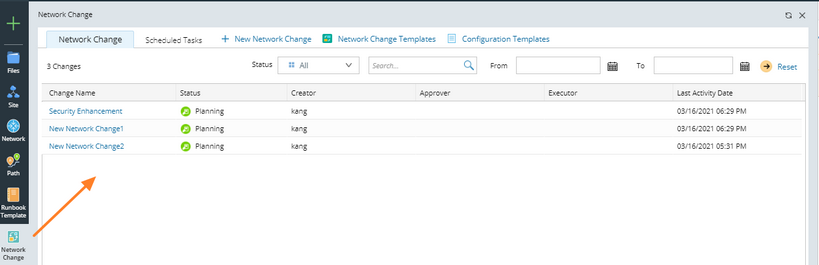

1.Click Network Change on the taskbar.
2.In the Network Change pane, click New Network Change.
Tip: The Network Change pane displays all network change tasks created in a domain.

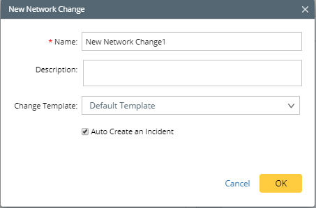

3.In the New Network Change dialog, enter the task name, select a template and click OK. The Runbook pane opens. Then you can define the network change task node by node in the runbook.
Note: You can keep the Auto Create an Incident check box selected to associated with an incident for cross-team collaboration. See Using Incident for more details.
