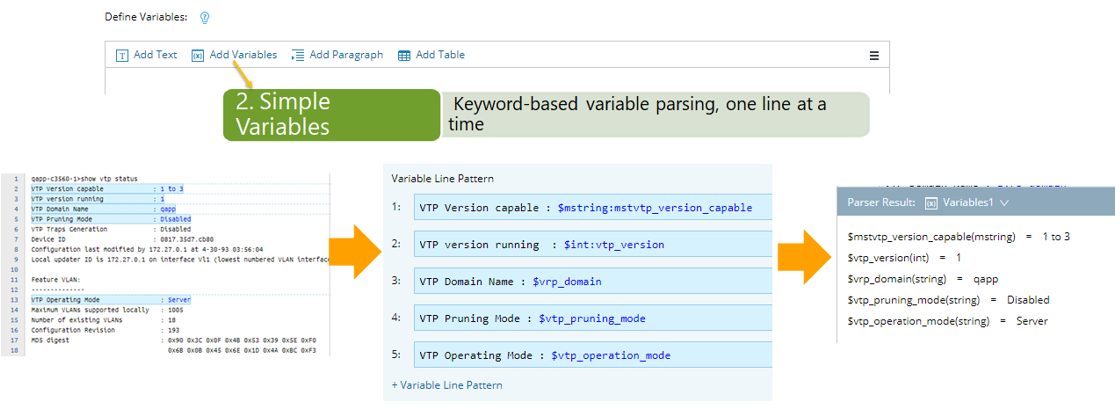

Simple Variable Parser
Simple variable parser can parse a single-value variable, such as version number, etc., by anchoring keywords before and after the variable. See Define a Simple Variable Parser for more details.

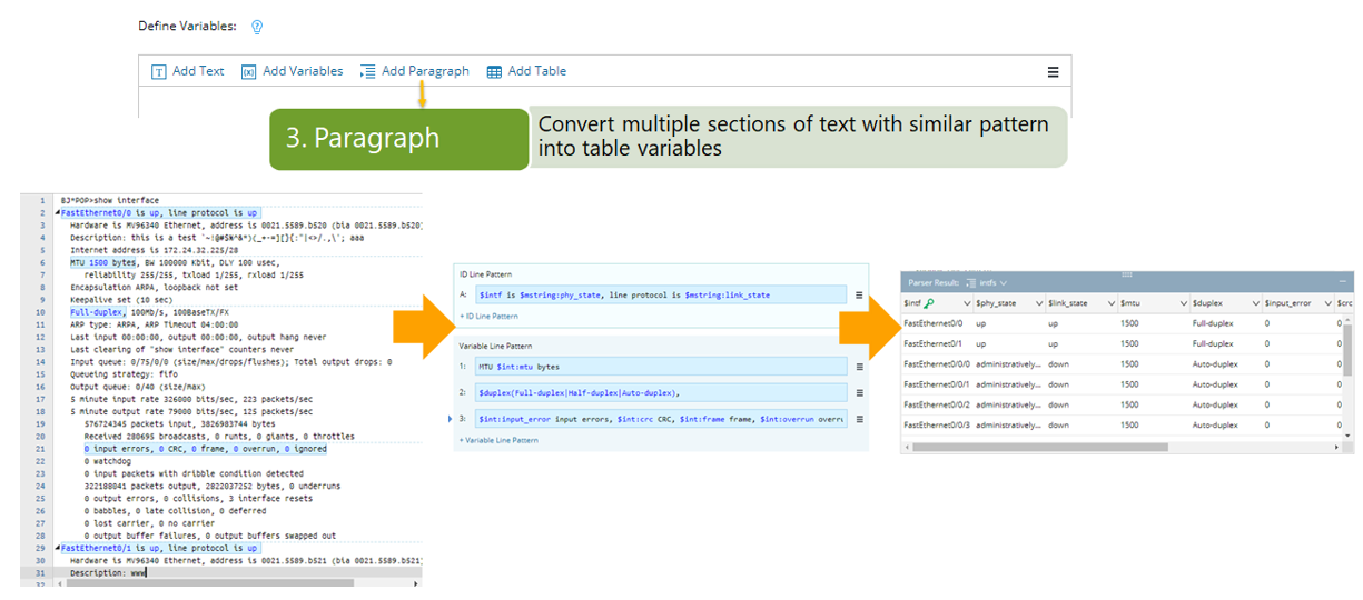

Paragraph Parser
Paragraph parser can parse variables in recurring paragraphs, such as collisions and CRC errors for interfaces, etc., by anchoring paragraph identifier (ID) lines. See Define a Paragraph Parser for more details.

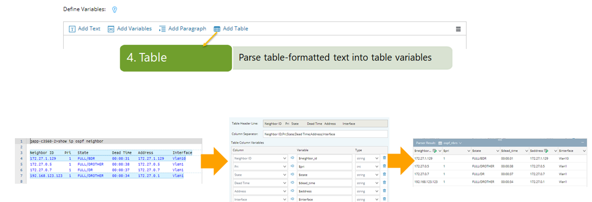

Table Parser
Table parser can parse table-formatted text, such as NDP table, VRF table, etc. See Define a Table Parser for more details.
