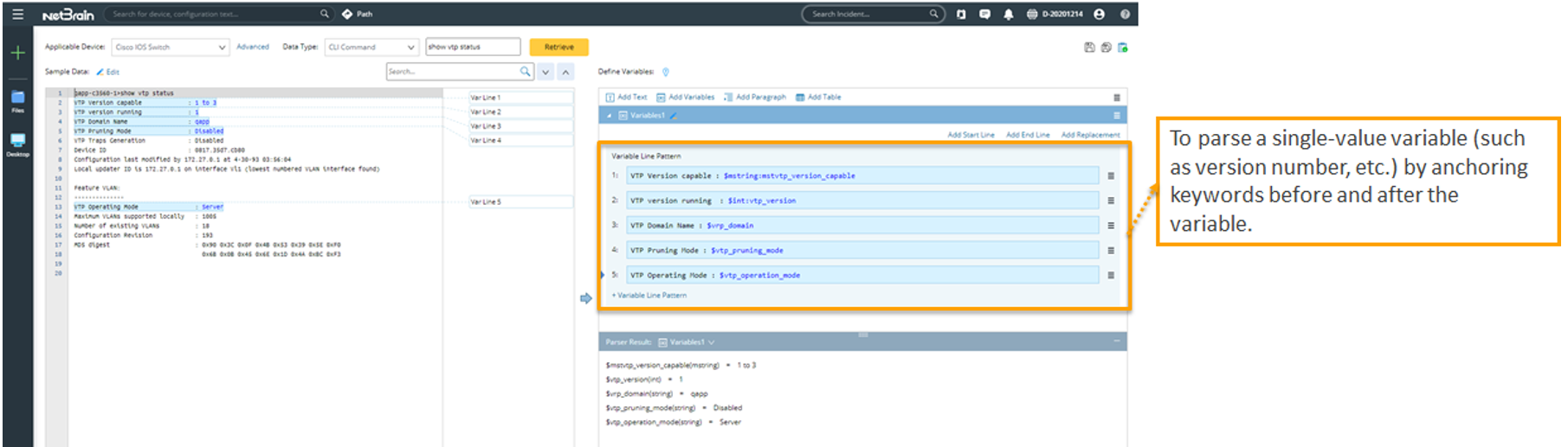

Keyword parser is used to parse a single-value variable (such as version number, etc.) by anchoring keywords before and after the variable. Each Variable Line Pattern in a keyword parser can be used to parse a variable within the full-text range, or to parse multiple variables in one line of text.

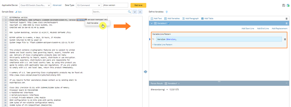

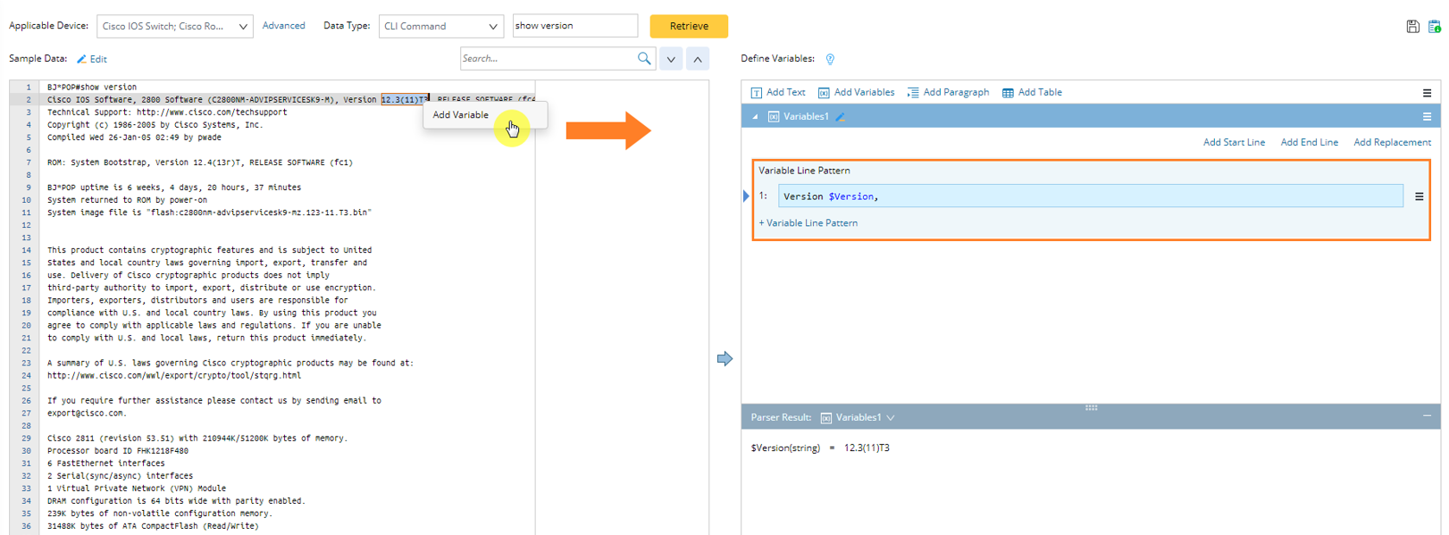

2.In the Sample area, select the value of version number 12.3(11)T3 and click Add Variable in the context menu.
Tip: You can also select the line of text in the Sample area and click the arrow (
) to duplicate it as the Variable Line Pattern.
Tip: The system uses the two words before and after 12.3(11)T3 as keywords to automatically generate the line pattern Version $version, RELEASE, using the notional word closest to the variable as the variable name (version in this example). If the word before or after the variable is “is”, “was”, “on”, “of”, “with”, “at”, “under”, “for”, “in”, or “:”, the system will look for one word further.
3.Edit the Variable Line Pattern if required. For example, rename the variable.
