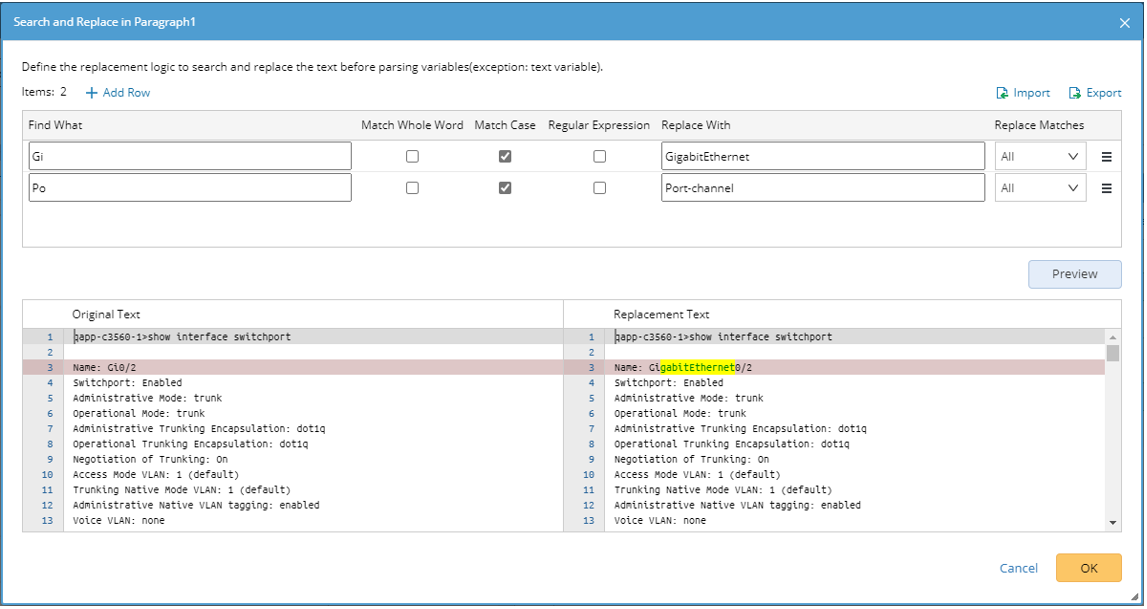

Text replacement is a flexible way to automate text pre-processing before it can be parsed as expected. When you want to search and replace any string in the raw text, you can define a text replacement.
Note: Text replacement is unavailable to Text Parser and cannot be applied to retrieved sample text.
Text replacement can be defined in two levels:
Global level: search and replace a string in the whole range of sample text.
Parser level: search and replace a string in the given range of text that has been matched by a specific parser’s definition.

When defining a text replacement, you can add multiple replacements rules. Each rule contains two objects as follows.
Find What - the text you are searching for in the given range.
oMatch Whole Word - once enabled, searches will only match if the result is a whole word, e.g., a search for “FastEthernet” will not return “FastEthernet1/2”.
oMatch Case - once enabled, search terms are case-sensitive, e.g., a search for “ethernet” will not return “Ethernet”.
oRegular Expression - once enabled, search terms will use the regular expression engine to find complex patterns in the text; otherwise, search terms will be interpreted literally.
Replace With - the text that will replace what is matched.
oReplace All Matches - replace all matches in the text scope.
oReplace First Only - replace the first match only.

Translate Interface Name
Sometimes interface names in the raw text are irregular and cannot be further used before manual processing.
