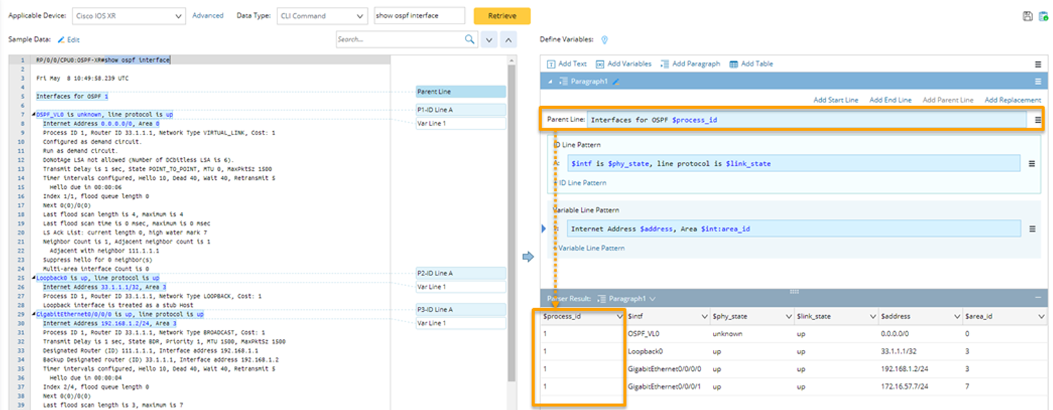

3.Optional: Define Parent Line Pattern to parse parent instance variables.
The parsed result of a paragraph parser is in a tabular shape. The variables defined in ID line patterns, variable line patterns, and parent line patterns (optional) will be formed as table columns.

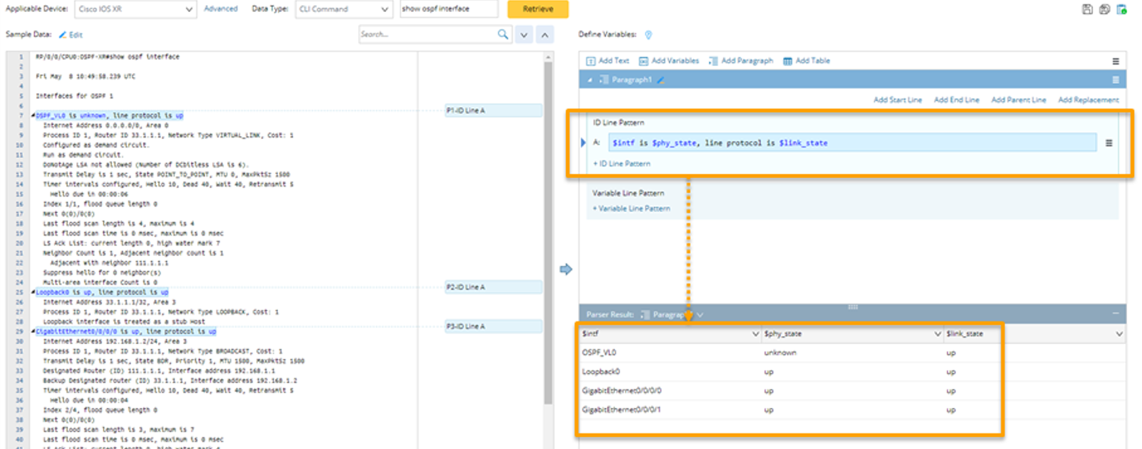

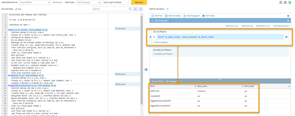

3.Define ID Line Pattern: anchor the paragraph identifier to identify recurring paragraphs.
1)Select an interface line of text in the Sample area, and click the arrow (
) to duplicate it as an ID Line A.
2)Define a string-type variable by replacing FastEthernet0/0 with $intf.
3)Define a multi-string variable by replacing up with $mstring:phy_state.
4)Define a multi-string variable by replacing up with $mstring:link_state.

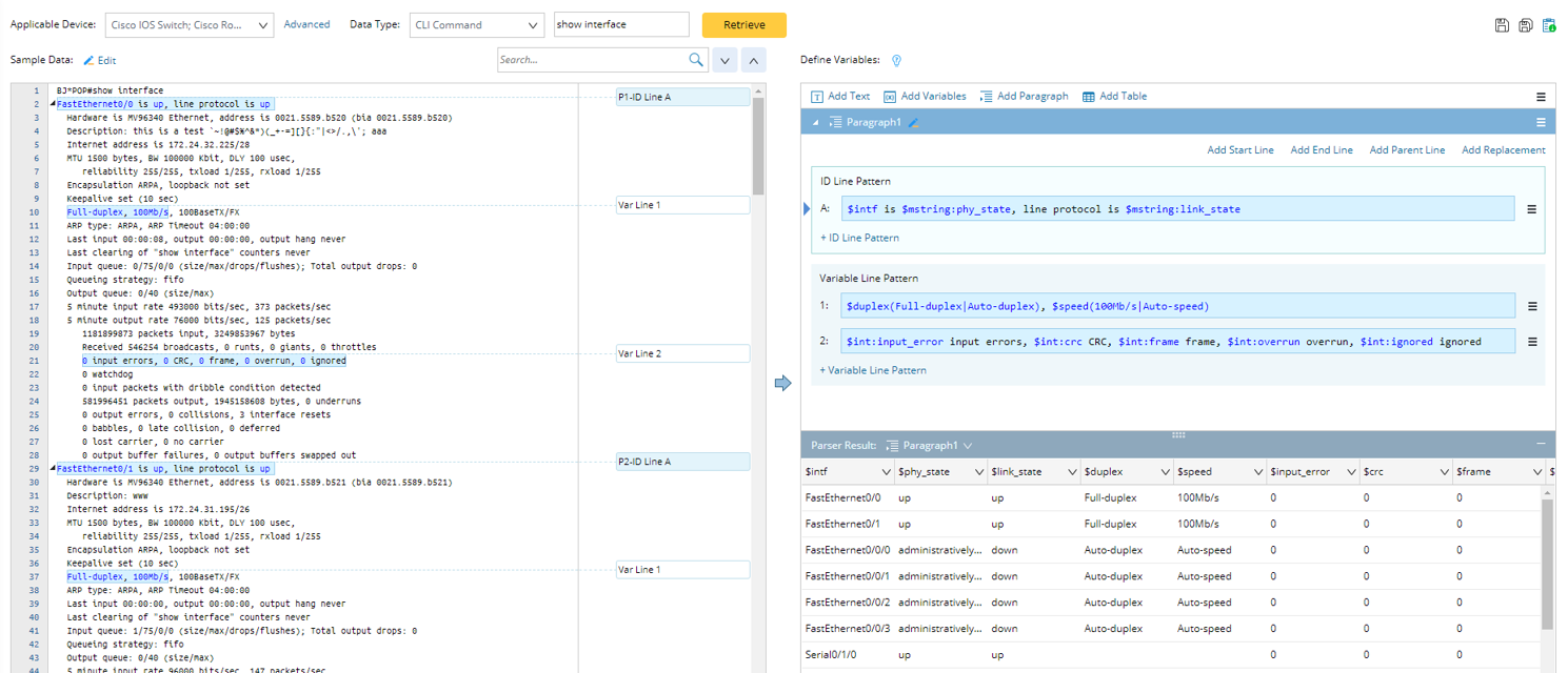

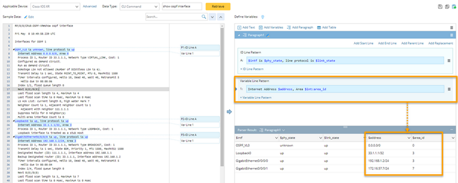

4.Define Variable Line Pattern: parsing variables inside each recurring paragraph and sub-paragraph that has been identified by ID Line Pattern.
1)Select Full-duplex, 100Mb/s, 100BaseTX/FX in the Sample area and click the arrow (
) to duplicate it as Variable Line 1.
2)In the Variable Line 1 field, replace Full-duplex, 100Mb/s, 100BaseTX/FX with $duplex(Full-duplex|Auto-duplex), $speed(100Mb/s|Auto-speed).
3)Select 0 input errors, 0 CRC, 0 frame, 0 overrun, 0 ignored in the Sample area, and click the arrow (
) to duplicate it as Variable Line 2.
4)In the Variable Line 2 field, replace 0 input errors, 0 CRC, 0 frame, 0 overrun, 0 ignored with $input_errors input errors, $crc CRC, $frame frame, $overunn overrun, $ignored ignored.
5.Preview the parsed result of sample text, and then click OK to save the paragraph parser.
