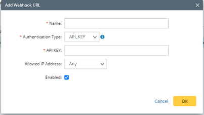

The Webhook URL can be created and enabled in NetBrain Workstation for the use of Splunk to build a connection with NetBrain Workstation. To enable Webhook URL, complete the following steps:
2.In the System Management page, select Operations > Webhook URL from the quick access toolbar.
3.Under Webhook URL tab, click +Add
4.Complete the required fields (Name/Authentication Type/API KEY) and select Enabled check-box.
5.Click Save.

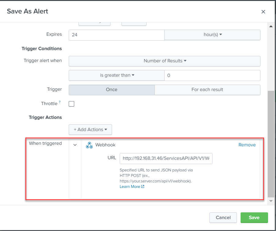

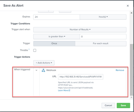

Define Webhook Alert Action
Webhook alert action is used to define the Webhook URL to create NetBrain map and execute Runbook Template when Splunk alert is generated. The following screenshot exemplifies the Save As Alert interface in Splunk App.
