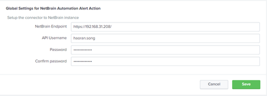

NetBrain offers two types of Splunk Apps for different deployment scenarios:
NetBrain Automation (Single-Domain): used for single Tenant/Domain deployment
oSingle Domain App Setting:

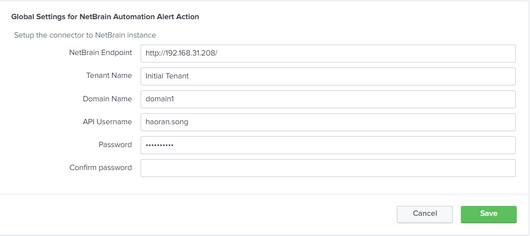

NetBrain Automation (Multi-Domain): used for multiple Tenants/Domains deployment.
oMultiple Domain App Setting:
