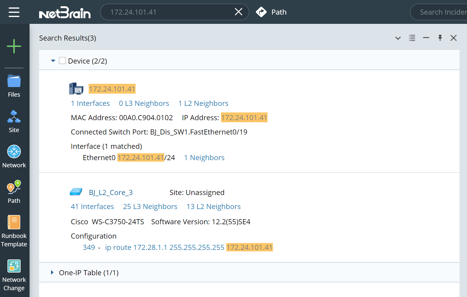

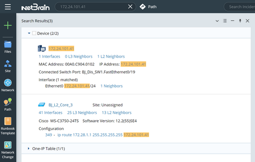

1.Enter an IP address in the search bar.
2.Press the Enter key to start searching. The search results are displayed with the matched keyword highlighted.
Tip: When searching for devices by using text string in the configuration file, you can select the Configuration tab to narrow down the search results to those which match the keyword combination exactly in their configuration files.

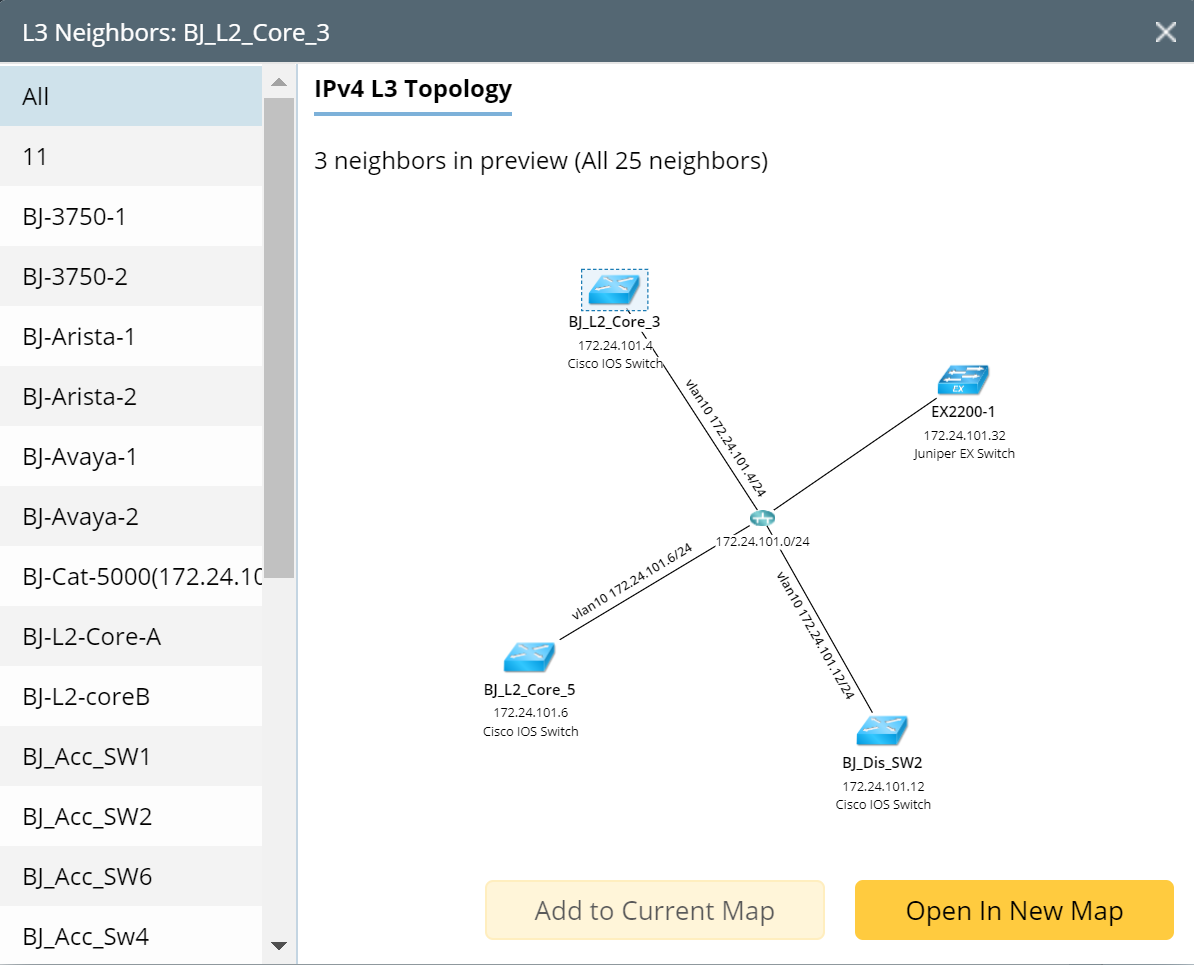

3.Click the X L3 Neighbors hyperlink (for instance, 25 L3 Neighbors). A preview map containing the searched device (for instance, BJ_L2_Core_3) and its neighbors are displayed.
4.To display the preview map on the existing map, click Add to Current Map; To display the preview map on a new map, click Open in New Map.

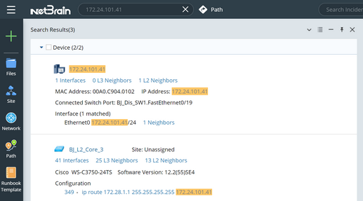

Click the device name in the search result. A Device Details dashboard matching its device type opens, showing the detailed information about the device. See Semantic Search for further operations. |
1)Point to the target device in the search result pane. 2)Click the |
1)Click the X L2 Neighbors hyperlink (for instance, 2 L2 Neighbors) to open the corresponding neighbor list as well as the preview map of the neighbor topology. 2)To open the preview map, click Open in New Map. |
1)Click the X Interface hyperlink (for instance, 15 Interfaces) to open the interface list of the device. 2)Click the IP address of the target interface. The system automatically starts a new search using the IP address as the keyword. |
