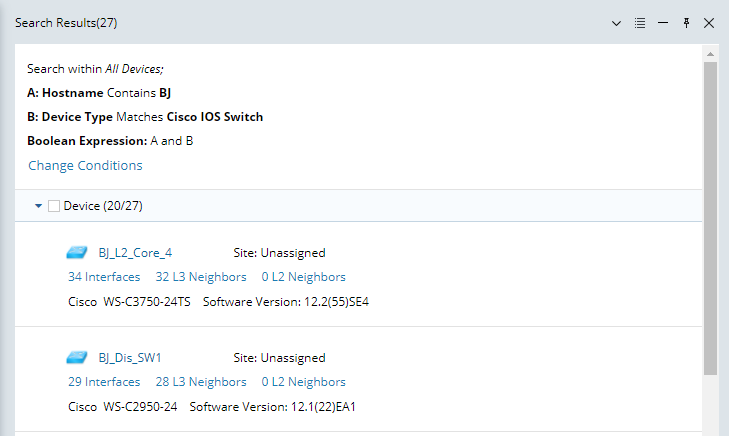

5.  Click Search. The searched result is displayed as follows:
