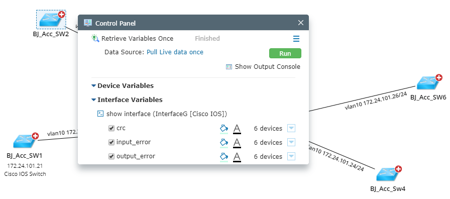

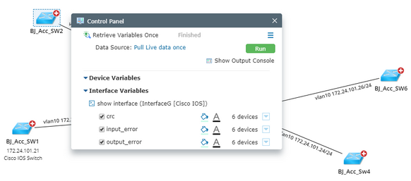

Instant Qapp Control Panel
The Control Panel of Instant Qapp will be launched as soon as you drag variables and drop them on a map.
This table introduces the follow-up actions that you can perform in the Control Panel:
Purpose
Action
To retrieve variables once
1)Select the variables and the data source to retrieve their values. By default, Current Baseline is selected. You can also select either Historical Data or live network as the data source.
2)Click Run. The system starts to retrieve the values of the variables. A static data view is auto-generated and applied on the map after the process is finished.
To monitor variables periodically
1)Select the variables that you want to monitor.
2)Click the hyperlink in the Data Source field to select Pull live data regularly, and specify the execution frequency.
3)Click Run. The system starts to monitor the values of the variables based on the specified frequency. A dynamic data view is auto-generated and applied to the map.
To adjust variable positions
1)Click the icon and select Change Position from the drop-down menu.
2)Select a device in the left pane, and adjust the variables on the device and interface labels.
3)Click OK. The system will start to refresh the values of the variables from the specified data source immediately.
Note: The variables that are not defined on the reserved positions will be placed to overflowed positions automatically.
