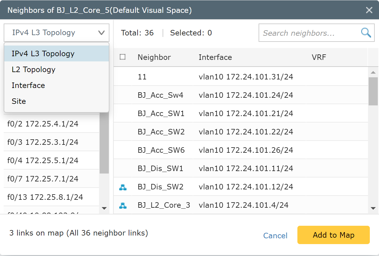

1)Select a neighbor type (such as IPv4 L3 neighbor device, L2 neighbor device, or neighbor site) from the drop-down menu to filter neighbors. See Neighbor Types for more details.
Note: To extend neighbors in L2/IPv6 L3 topology, or L3 VPN tunnel, make sure that the topology type has been built via a Benchmark task. See Benchmark Task Settings for more details.
2)Select an interface in the left pane. The connected neighbor devices or sites are listed on the right side.
3)Select one or multiple neighbor devices or sites, and then click Add to Map. You can also double-click All Neighbors to add all the listed neighbor devices to the map.

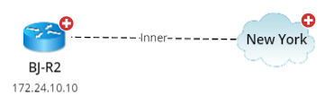

The device is an inner device of this site, indicating that it is not connected to any devices from other sites. |

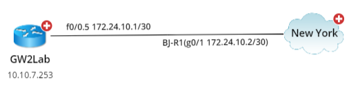

The device does not belong to the site, and connected to a device (BJ-R1) within the site. |

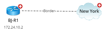

The device is a border device of this site, indicating that it is connected to devices in other sites. |
