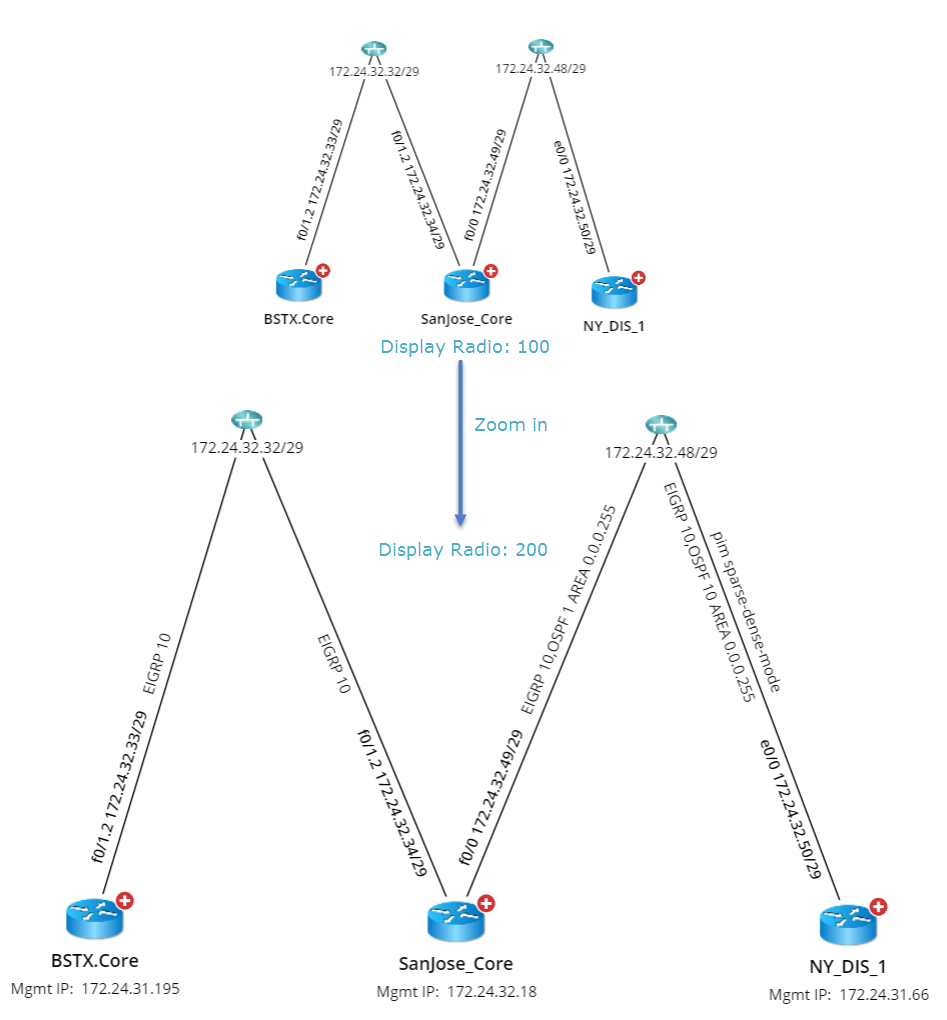

Zooming In
Each map is displayed at 100% zoom level by default. You can zoom in by rotating your mouse wheel button forward to browse more data units:
