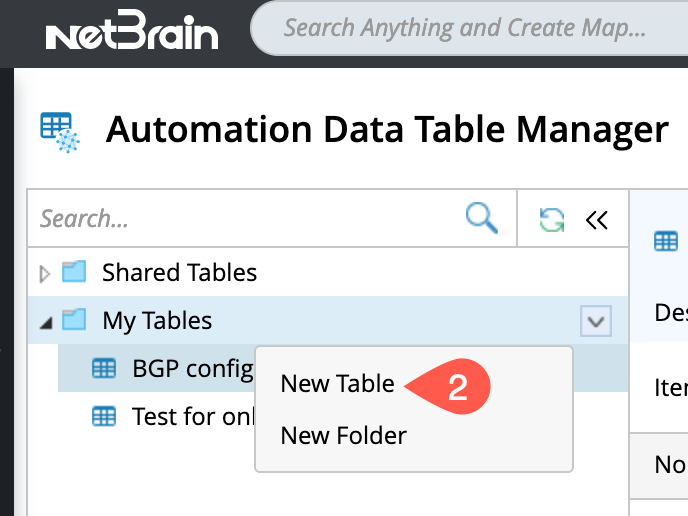

- open the Automation Data Table by searching for it in the Start menu.

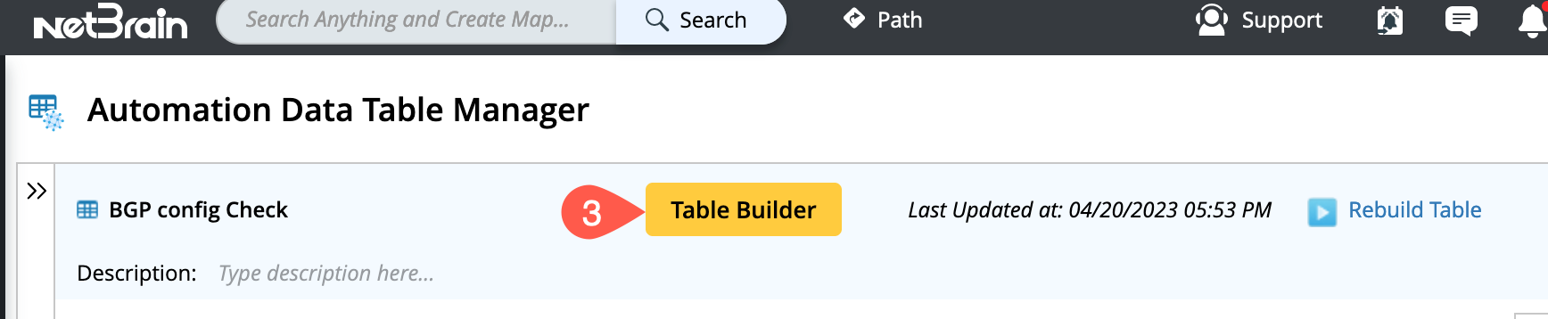

In the My Tables folder, create a new table and give it a name that describes its purpose. For instance, named it as BGP Config Check.
- Click on the Table Builder button to open the Automation Data Table Builder window.

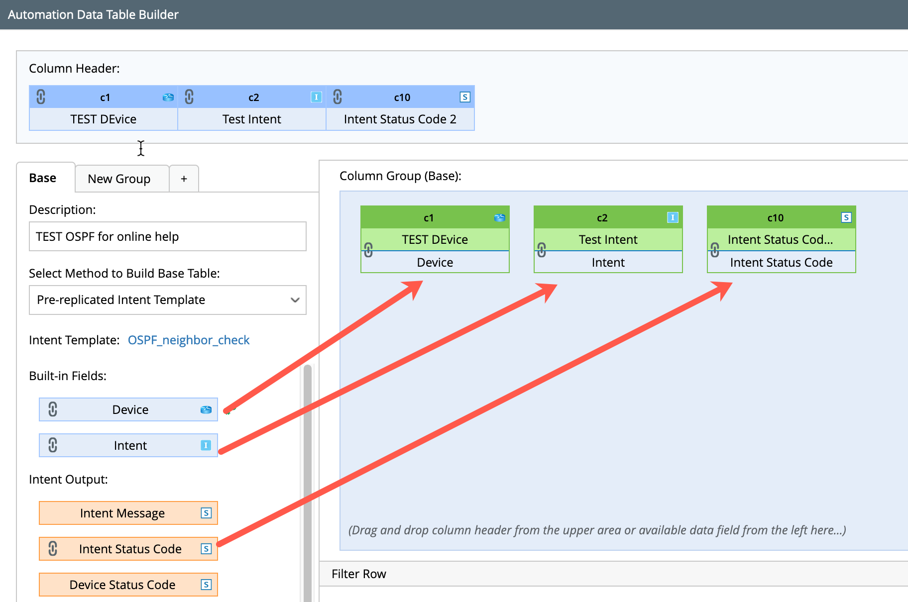

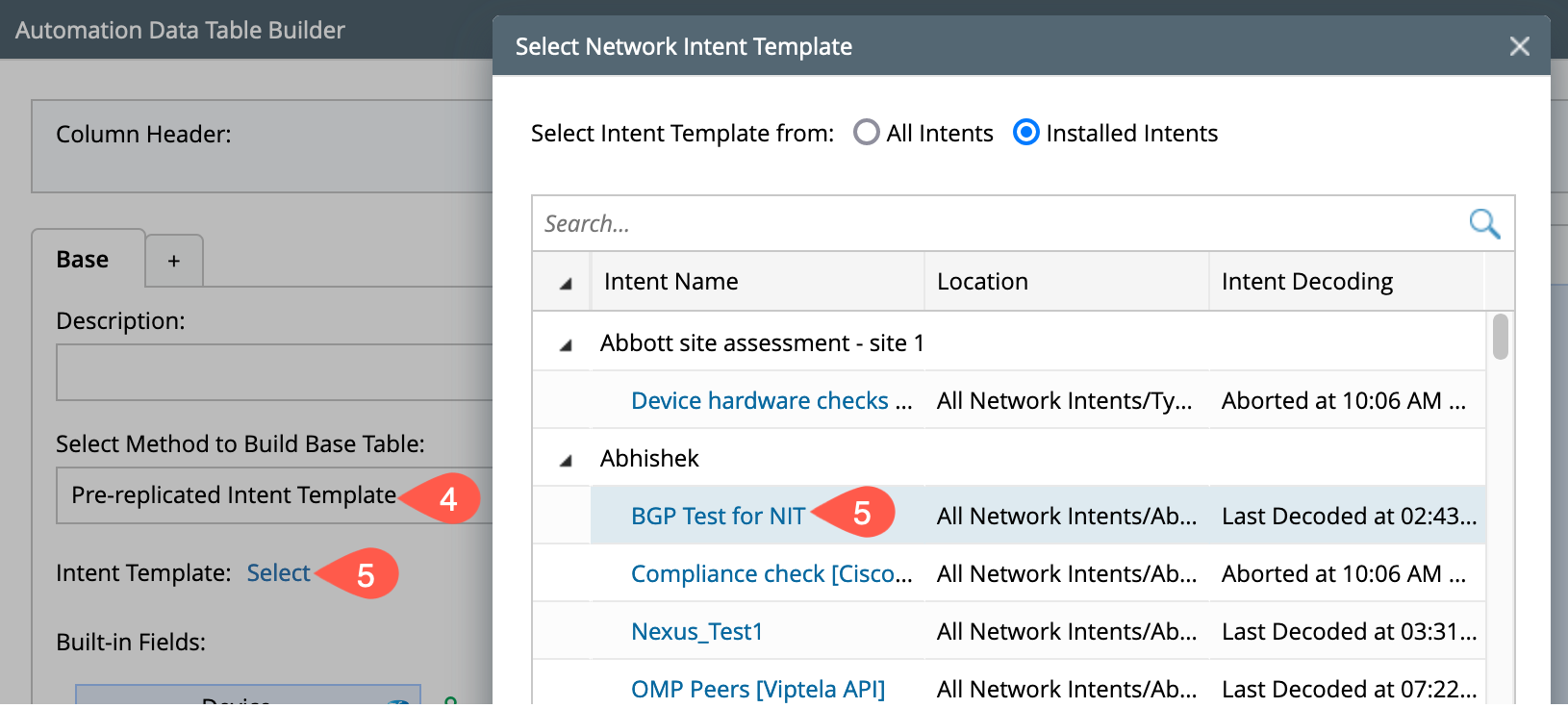

- Go to the default Base tab, select Pre-replicated Intent Template as the method to build base table data from the intent template properties.
- Click Select and browse to the location of the predefined Intent Template and add it, which is installed in Intent Based Automation Center (Intent Library) .
Drag and drop the Built-in Fields and Intent Status code (as needed for your use case) to the Column Group.

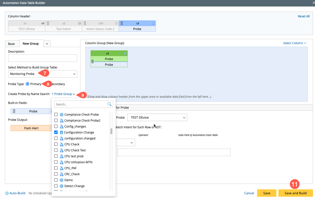

- Add a new column group and select the Monitoring Probe method to build a group table.
- Select Primary as the probe type and drag the built-in field Probe to the column group.
- Choose a probe group from the drop-down menu located next to the Create Probe by Name Search field.

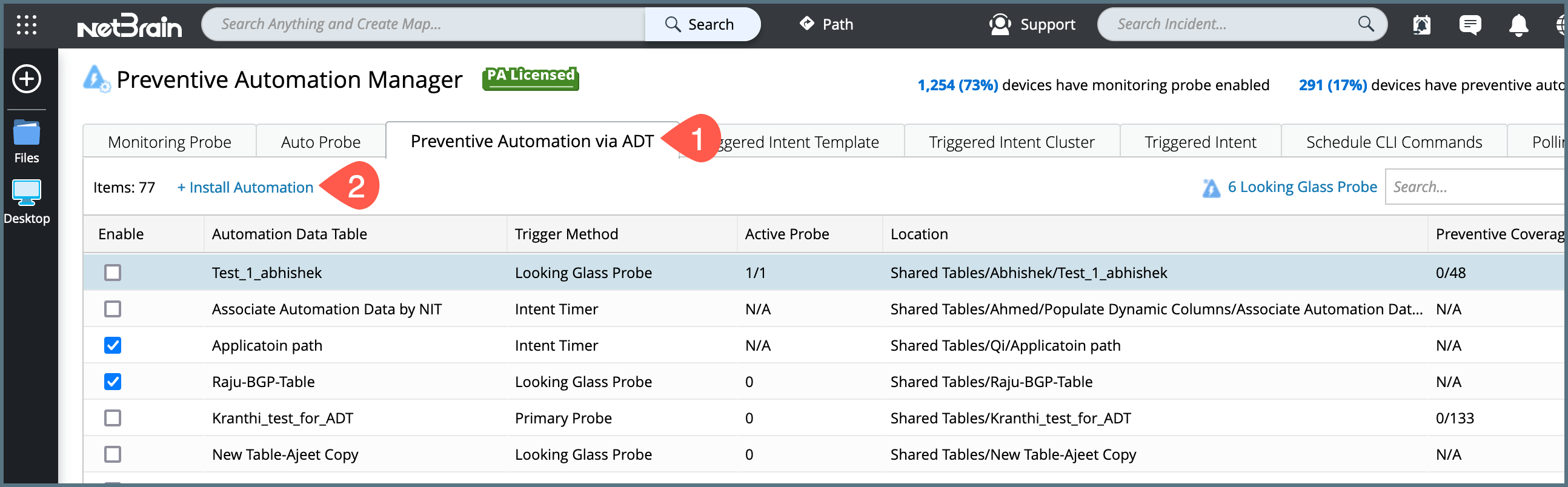

- Open the Preventive Automation Manager from the netbrain desktop and go to Preventive Automation via ADT tab.
- Click on +Install Automation to open a pop-up window Install Preventive Automation via ADT.

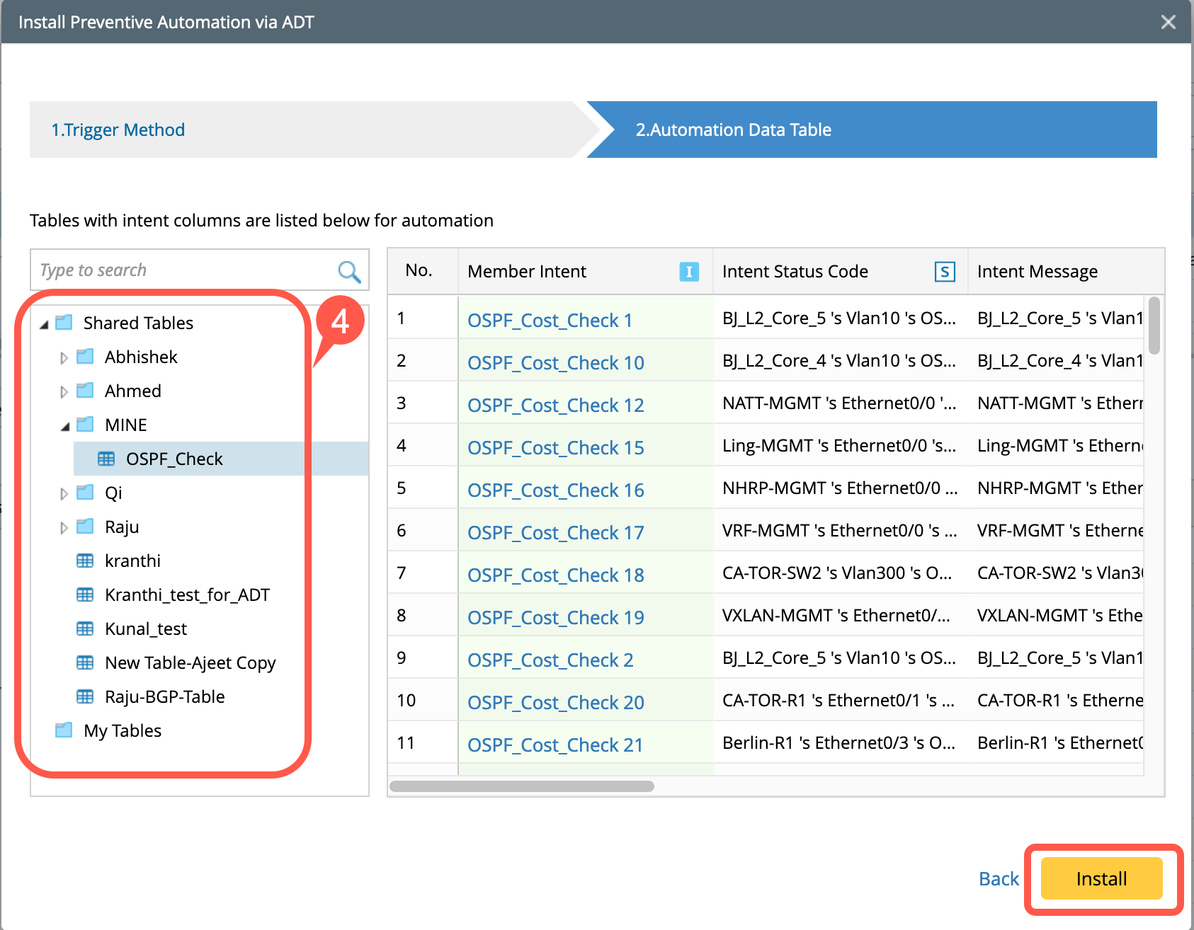

- Select one of the Trigger Method to configure and click on Next located at the bottom right side of the window.
- Search for the predefined ADT table in the list and click on Install.
- The automation item will be created by the system and appear in the list.
