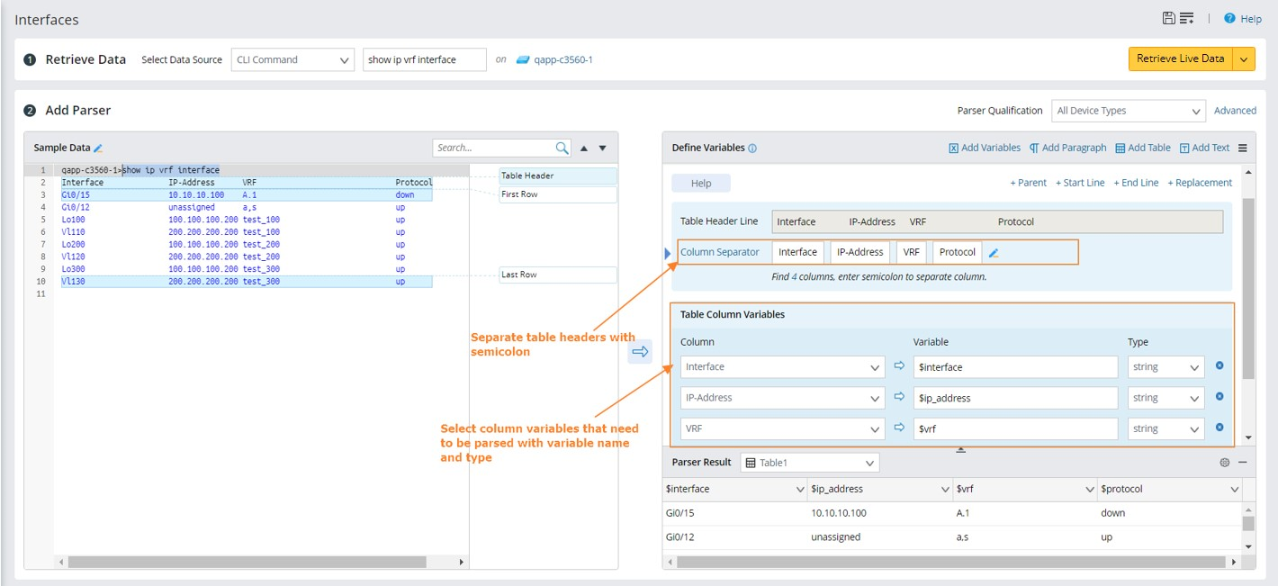

Defining a Table Parser to Parse VRF Table
Take the parsing of the VRF table as an example. You can define a Table Parser to parse the VRF table.
  1. Retrieve sample text.
  2. Select a Parser type by clicking Add Table.

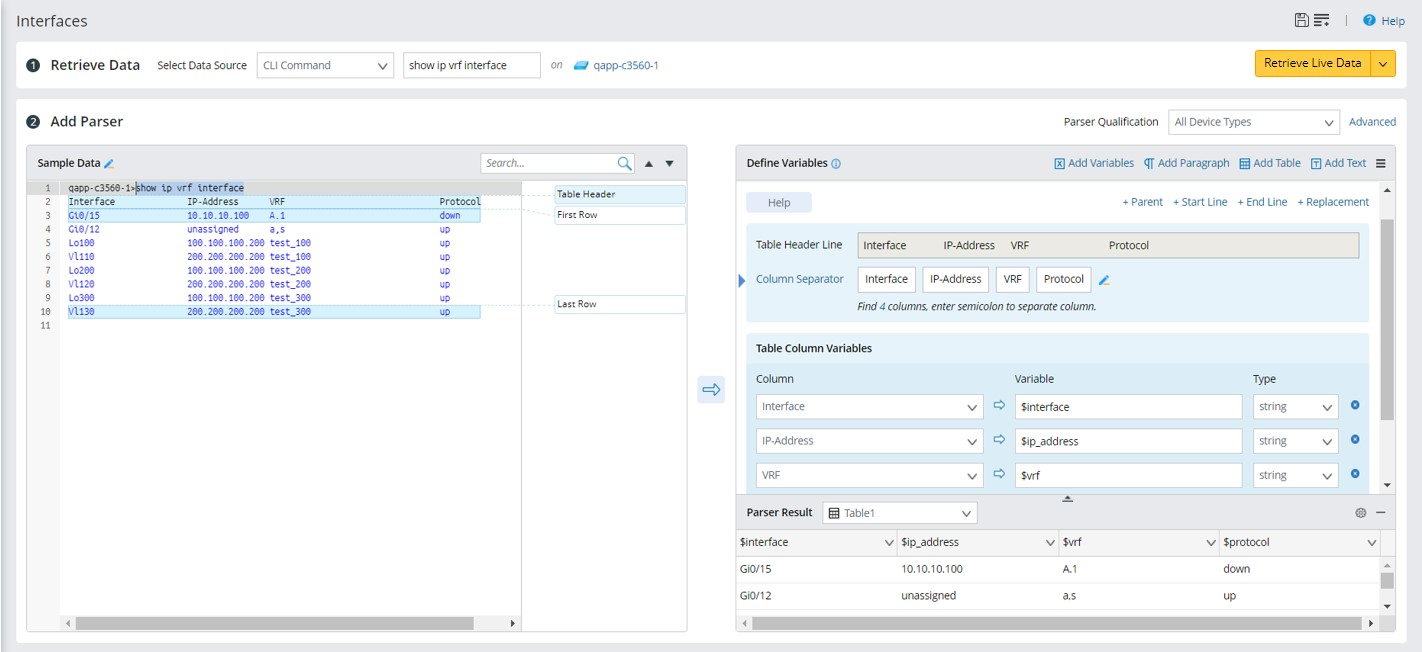

  3. Select the line of the table header in the Sample area, and click the arrow () to duplicate the text in the Table Header Line and Column Separator field.
    Information Tip: Users can also click Set as Table Header in the dropdown after selecting the line of table header in the Sample area.
  4. In the Column Separator field, add a semicolon (;) to separate every two column names.
  5. In the Table Column Variables area, select variables required to parse, rename and select their types.
  6. Preview the parsed result of sample text, and click OK to save the Table Parser.
