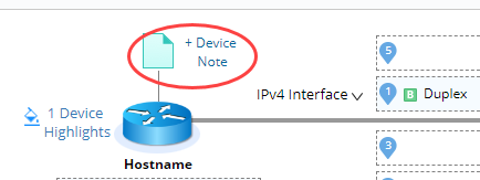

Click Device Note and start to define the note.

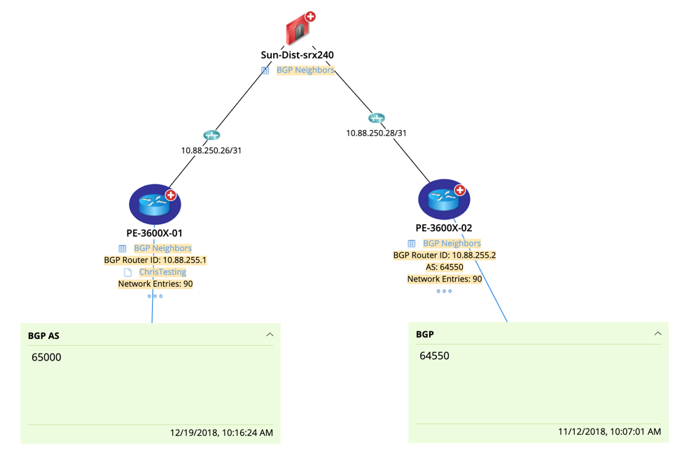

  • Individual Device Note  a note linked to one device. Each qualified device displays its own device note.
    Diagram  Description automatically generated

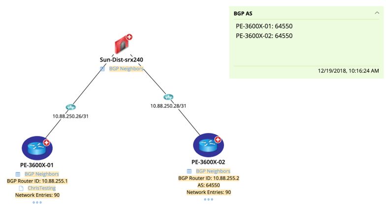

  • Compound Note (Append) — a note linked to multiple devices, and its content is merged with the notes of these devices. Each note uses the hostname of the device as its prefix.

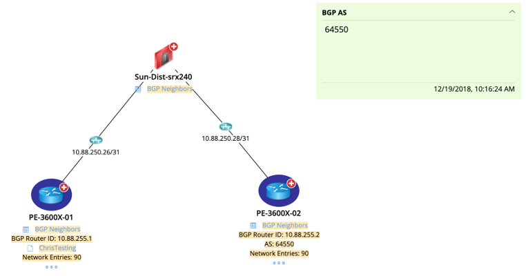

  • Compound Note (Overwrite)  a note linked to multiple devices, but its content is the latest note for one device. A new one will overwrite the previous note.
