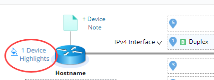

Properties of Device Highlight
Click Device Highlight and start to define the highlight.
Diagram
The following table lists the properties of a device highlight.
PropertyDescription
Highlight Node by VariablesSelect a variable highlighting qualified traditional devices or SDN nodes on a map.
Display Highlight When
Set a condition to control when to display this device highlight.
  • The default value - Always, indicating this highlight will be displayed under any circumstances.
  • If you select an option variable as a condition, then the highlight will be only displayed when the value of the selected variable is:
  • Non-empty (for string type)
  • Not equal to (for number type)
  • equal to true (for boolean type)
Note: Both device-level variables and input variables in the supporting variable list of the current data view template can be selected to define the display conditions for device highlights.
Note: Table-type and list-type variables cannot be used as conditions.
LegendThe legend displayed on a map is to illustrate this device's highlight.
ColorCustomize the color for the device highlight. The default value is Random Color.
