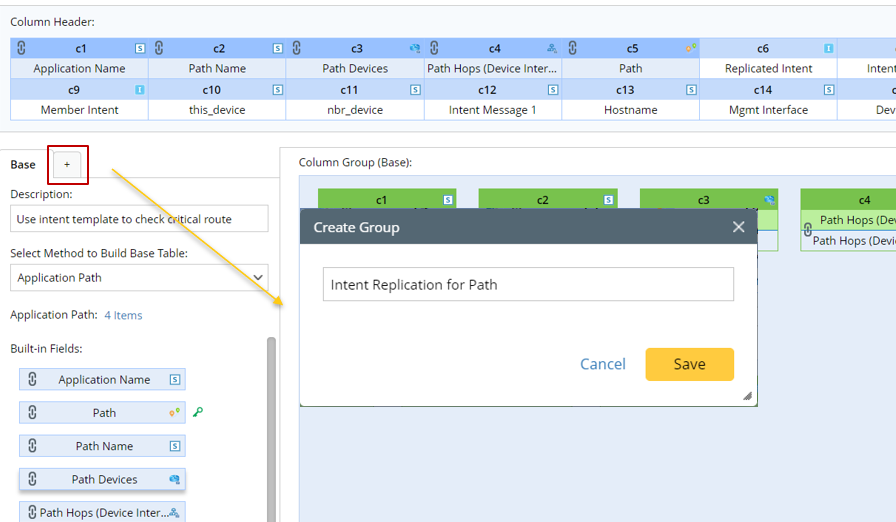

  1. Go to Automation Data Table Builder, then create a new group and name it (for example, Intent Replication for Path).

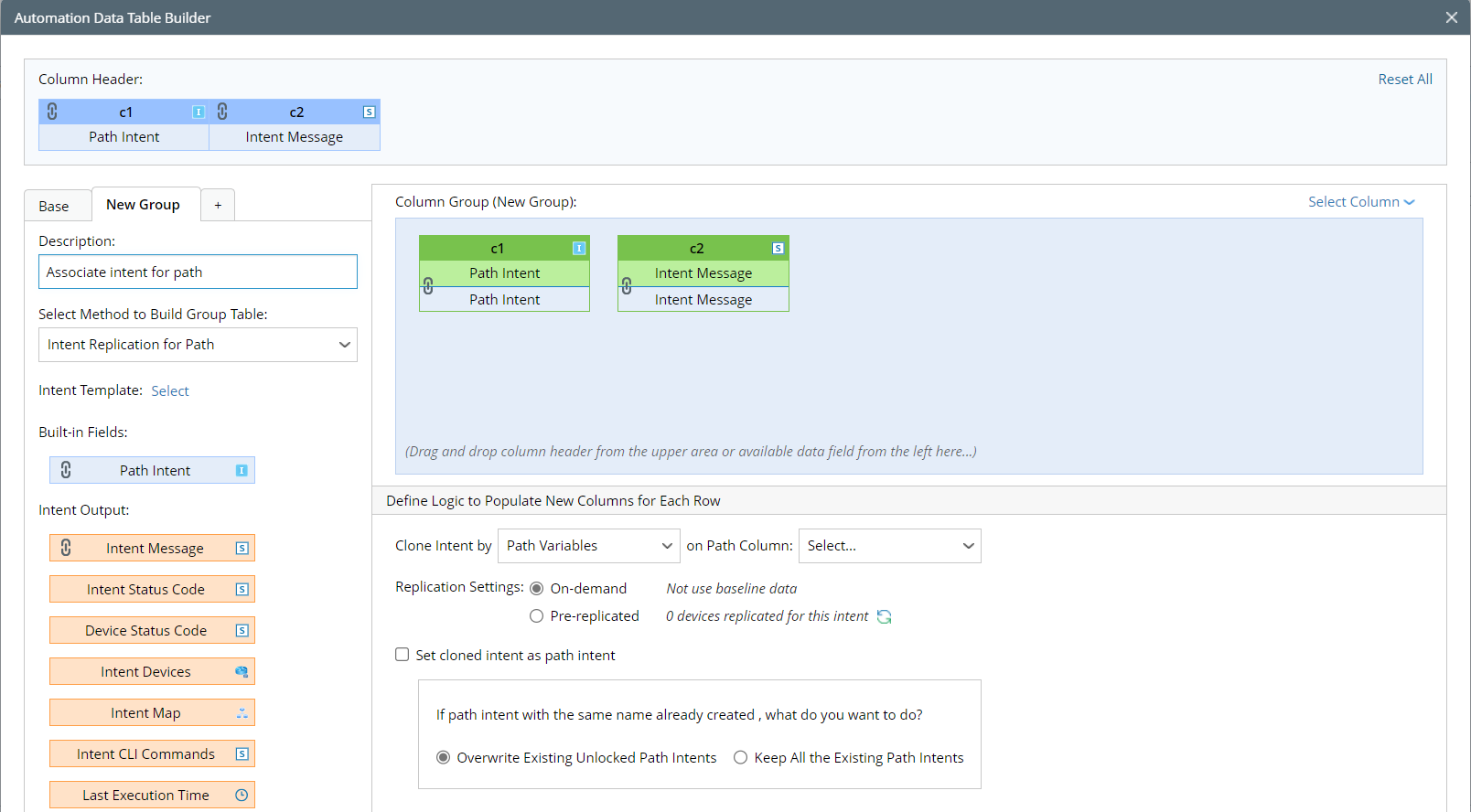

  2. Under the new Group tab (for example, Intent Replication for Path tab), define the following settings:
    • Description: Input descriptions for the base table to describe its use and function.
    • Select Method to Build Group Table: Select Intent Replication for Path.
    • Intent Template: Select the created intent template (for example, intent template "L3 - OSPF Check [Cisco IOS]") for building this column group.
      To use the Intent Replication for Path method, it is required to select a path-based NIT as data source, which also means only path variables are used for intent replication. Therefore, in the Filter by field, Path-based option is selected by default. If the selected NIT is not configured for path replication, a message will appear to notify you.
  3. Mapping Available Fields to Column Group: Drag and drop the available fields to the column group definition area to create ADT columns automatically. There are three field categories in this area to be selected:
    Information Note: To perform common operations on a column, click corresponding items from the drop-down menu.
  • Built-in Fields: The built-in field "Path intent" is available for this group table.
  • Intent Outputs: Other intent information can be displayed in the intent output columns of the ADT, such as intent message, intent status code, intent devices, intent map, intent CLI commands, and last execution time.
  1. Define logic to Populate New Columns for Each Row: In this area, you can add data to ADT columns via the intent template.
  • Clone intent by Path Variables on Path Column: Select Path Column to use the data source for intent replication, e.g., the Path Variables column.
  • Advanced Settings: Click Advanced Settings to make more definitions for populating column.
    • Set cloned intent as path intent: Check the checkbox to enable this function so that the created intent will be added to the Path.
      Overwrite Existing Unlocked Path Intents: The new path intent will replace the existing path intent associated with the Path.
      Keep All the Existing Path Intents: Only keep all the exiting path intents associated with the Path.
    • Lock Settings: Turn on Lock to define the lock settings.
      With Password: Lock the replicated path intent without password.
      Without Password: Enter and confirm password, then the replicated path intent will be locked with password.
      Lock Annotation: Input information about locking the path intent.
  1. Click Save and Build to save the setting.

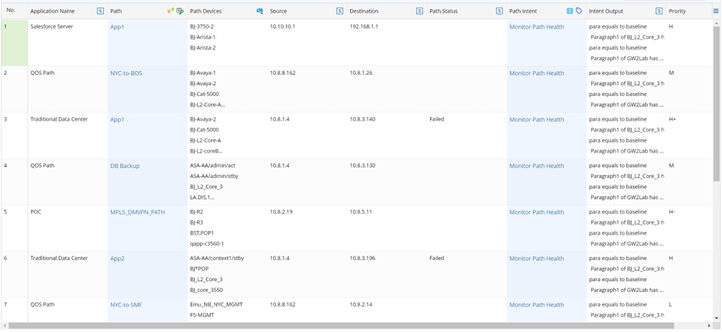

  3. View the path intent replication result in ADT to check if the path intent is created in ADT.
  4. View the Path intent details in the path browser to check if the path intent is added to the target path.
