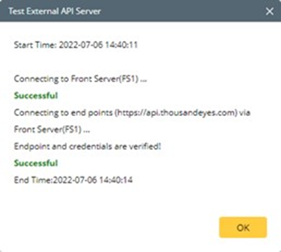

  6. Click Test to initiate a connectivity test between the NetBrain front server and the ThousandEyes Cloud API configured.
Test Results
Screenshots
Successful Connection

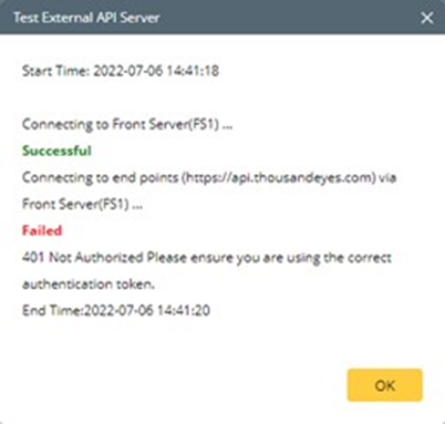

Error Scenario: The entered credentials are incorrect.
Possible Resolution: Confirm credentials specified in the ThousandEyes API Adaptor configuration and retry.
