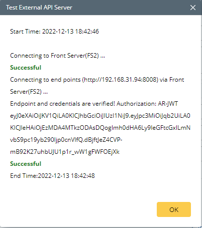

  6. Click Test to initiate a connectivity test between the NetBrain front server and the BMC Remedy instance configured.
    Test ResultsScreenshots
    Successful Connection

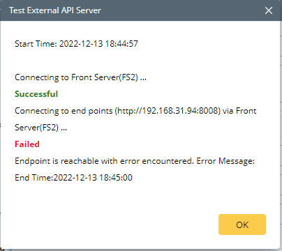

    Error Scenario: The entered credentials are incorrect.
    Possible Resolution: Confirm credentials specified in the BMC Remedy API Server configuration and retry.

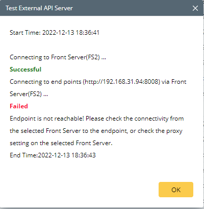

    Error Scenario: BMC Remedy endpoint is unreachable.
    Possible Resolution: Confirm that the NetBrain Front Server(s) can reach the BMC Remedy Server on Port 8008 via HTTPs
