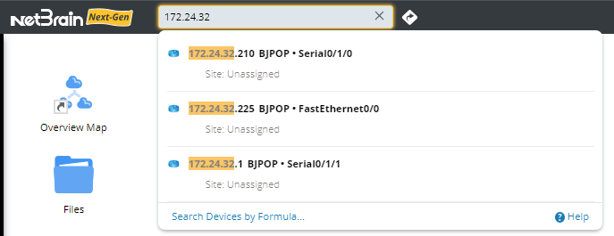

  1. Enter an IP address in the search bar.
  2. Press the Enter key to start searching. The search results are displayed with the matched keyword highlighted.

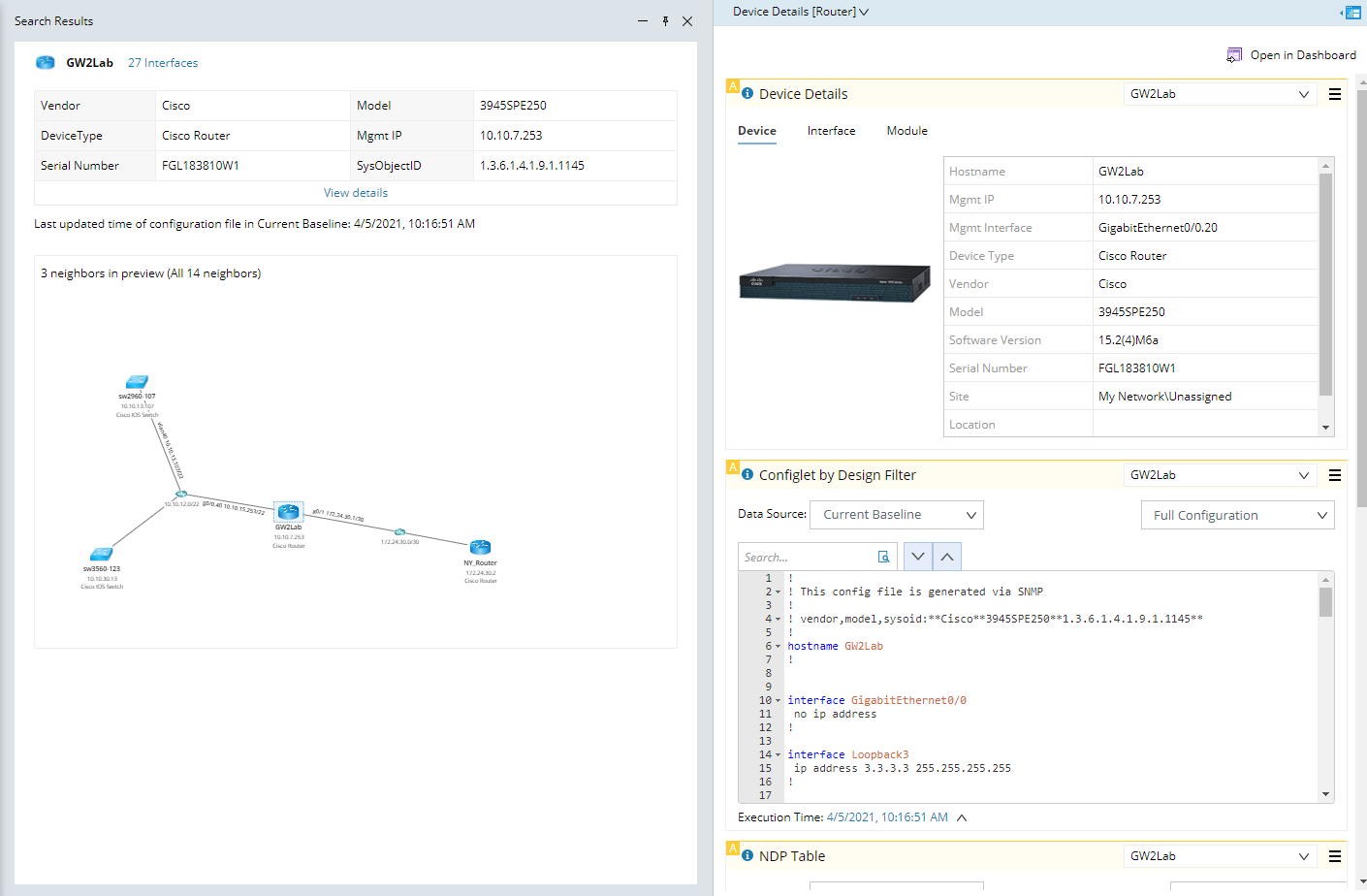

  1. Click the X L3 Neighbors hyperlink (for instance, 27 L3 Neighbors). A preview map containing the searched device (for instance, BJ_L2_Core_3) and its neighbors is displayed.
  2. To display the preview map on the map that is already open, click "Add to Current Map"; to display the preview map on a new map, click "Open in New Map."
Further operations:
  • Viewing device details in a dashboard
    Click the device name in the search result. A Device Details dashboard matching its device type opens, showing the detailed information about the device. See Semantic Search for further operations.
    A screenshot of a computer  Description automatically generated with medium confidence
  • Browsing device details in the device details pane
  1. Point to the target device in the search result pane.
  2. Click the  icon and select View Device Details from the drop-down menu. See  Device Details for more details.
