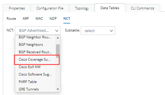

- Double-click a Cisco device to open the Device Details pane.
- Select the Data Tables tab> NCT tab
- Select Cisco Coverage Summary from the drop-down.

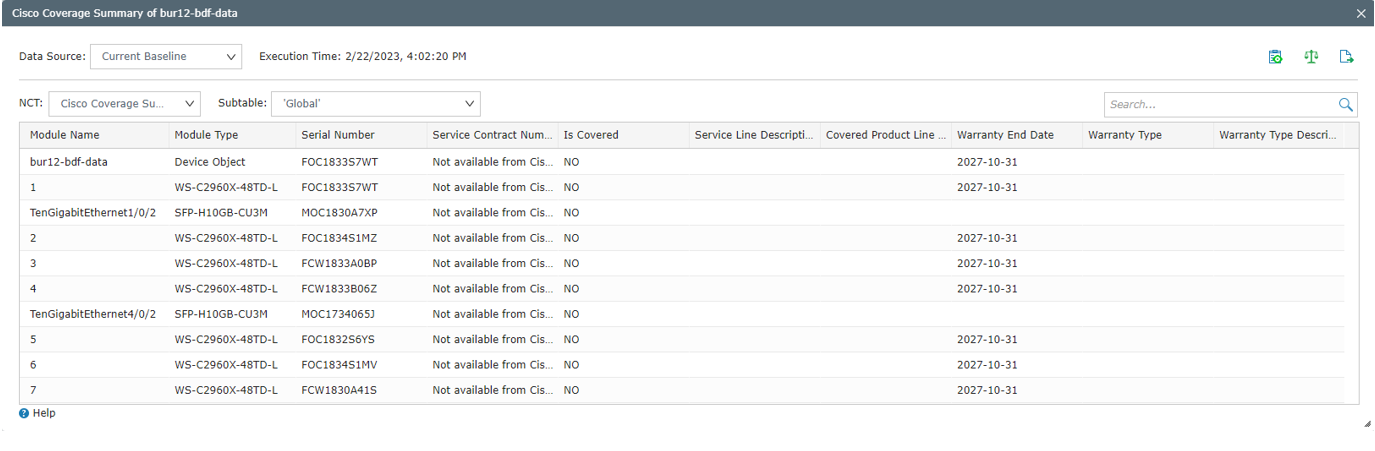

NetBrain includes the following information in the Cisco Coverage Summary NCT table.
- Module Name
- Module Type
- Serial Number
- Service Contract Number
- Is Covered
- Service Line Description
- Covered Product Line End Date
- Warranty End Date
- Warranty Type
- Warranty Type Description

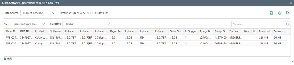

- Select Cisco Software Suggestions from the drop-down.
NetBrain includes the following information in the Cisco Software Suggestions NCT table.
- Base PID
- MDF ID
- Product Name
- Software Type
- Release Format 1
- Release Format 2
- Release Date
- Major Release
- Release Train
- Release Life Cycle
- Release Display Name
- Train Display Name
- Is Suggested
- Image Name
- Image Size
- Feature Set
- Description
- Required RAM
- Required Flash
