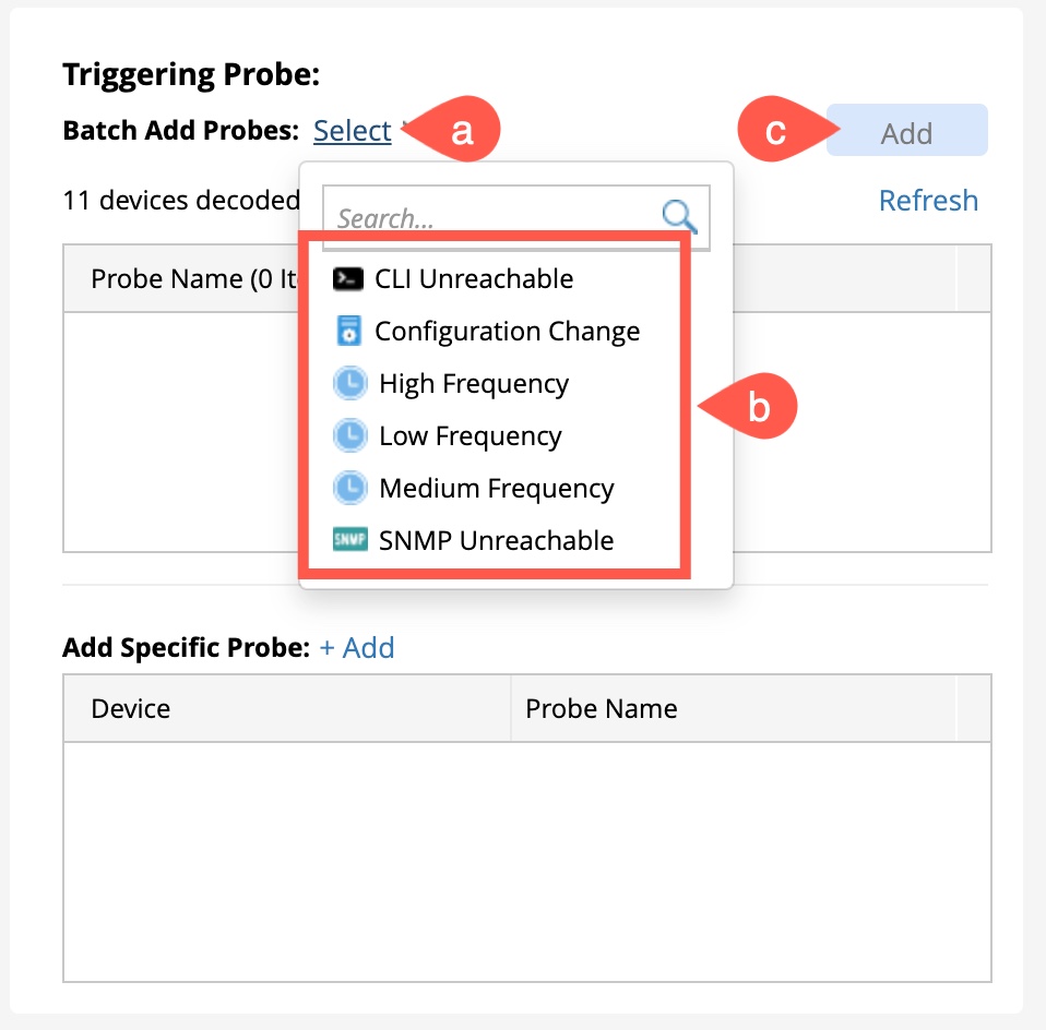

  1. Add probes as a batch:
    1. Click on the link Select next to Batch Add Probes, and a drop-down window will appear.
    2. Select the required probe from the drop-down window.
    3. Click Add, and the corresponding probe name and device count are added to the list.

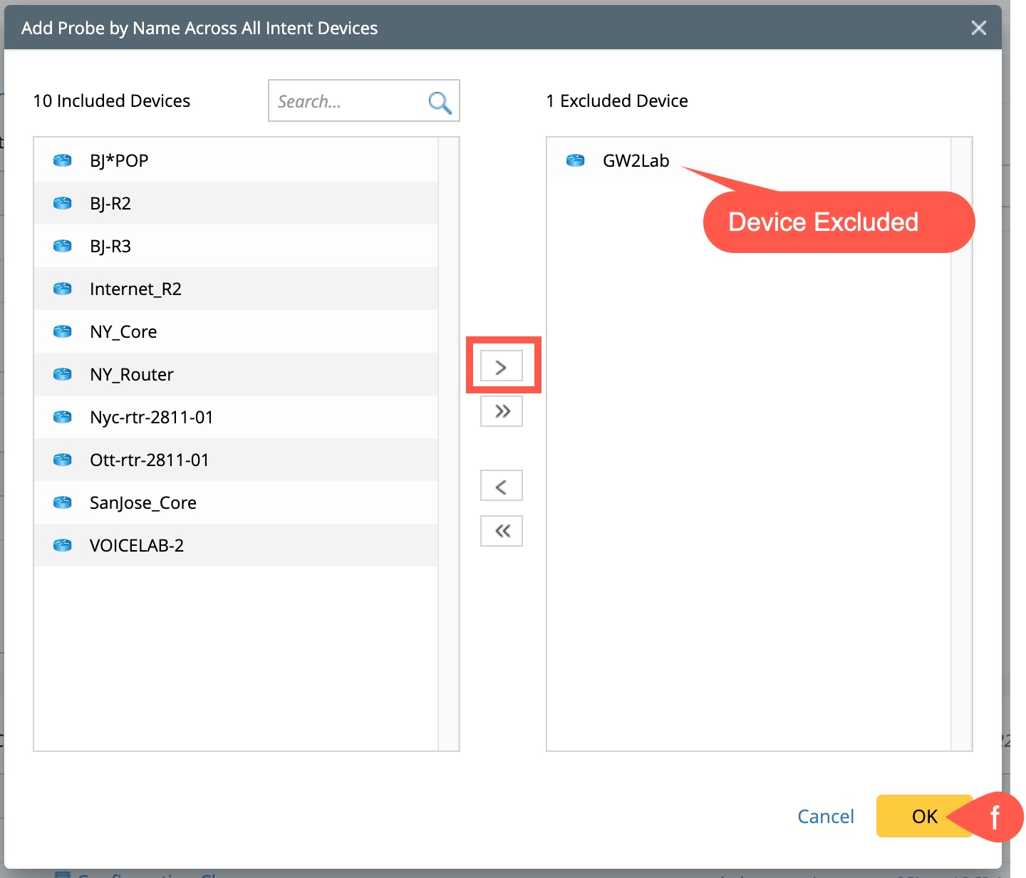

    4. To exclude devices from the batch, click on the probe count to open a window Add Probe by Name Across All Intent Devices.
    5. Information NOTE: By default, all the device probes are included.
    6. Select the devices you want to exclude and click on the  button to move the devices to Excluded Device column on the right.
    7. Click OK to save and close the modifications.

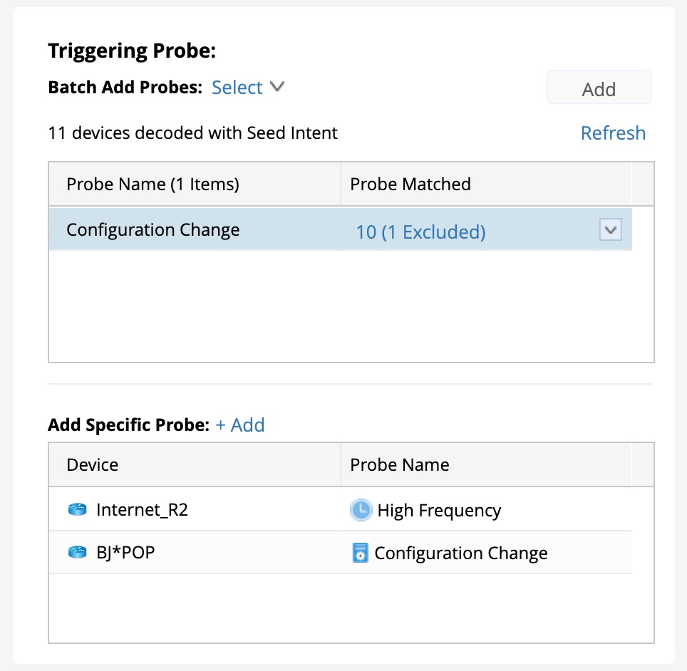

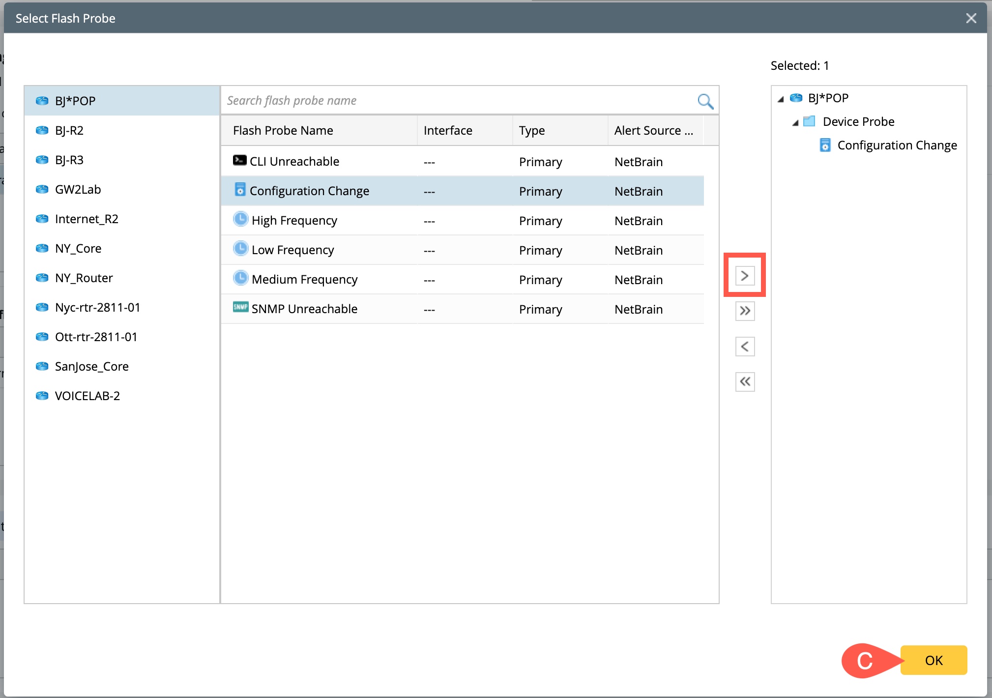

  2.  Adding a Specific Probe:
  3. Information NOTE: Probes excluded in the batch can be added to the final probe list using Add Specific Probe.
    1. Click on +Add available next to Add Specific Probe to open the pop-up window Select Flash Probe.
    2. Select the specific device Bj*POP and flash probe Configuration Change and click on to add them to the list.
    3. Click OK to save and close the pop-up window Select Flash Probe.
    The final probe list is a collection obtained from both sections Add Probes by Name and Add Specific Probe.

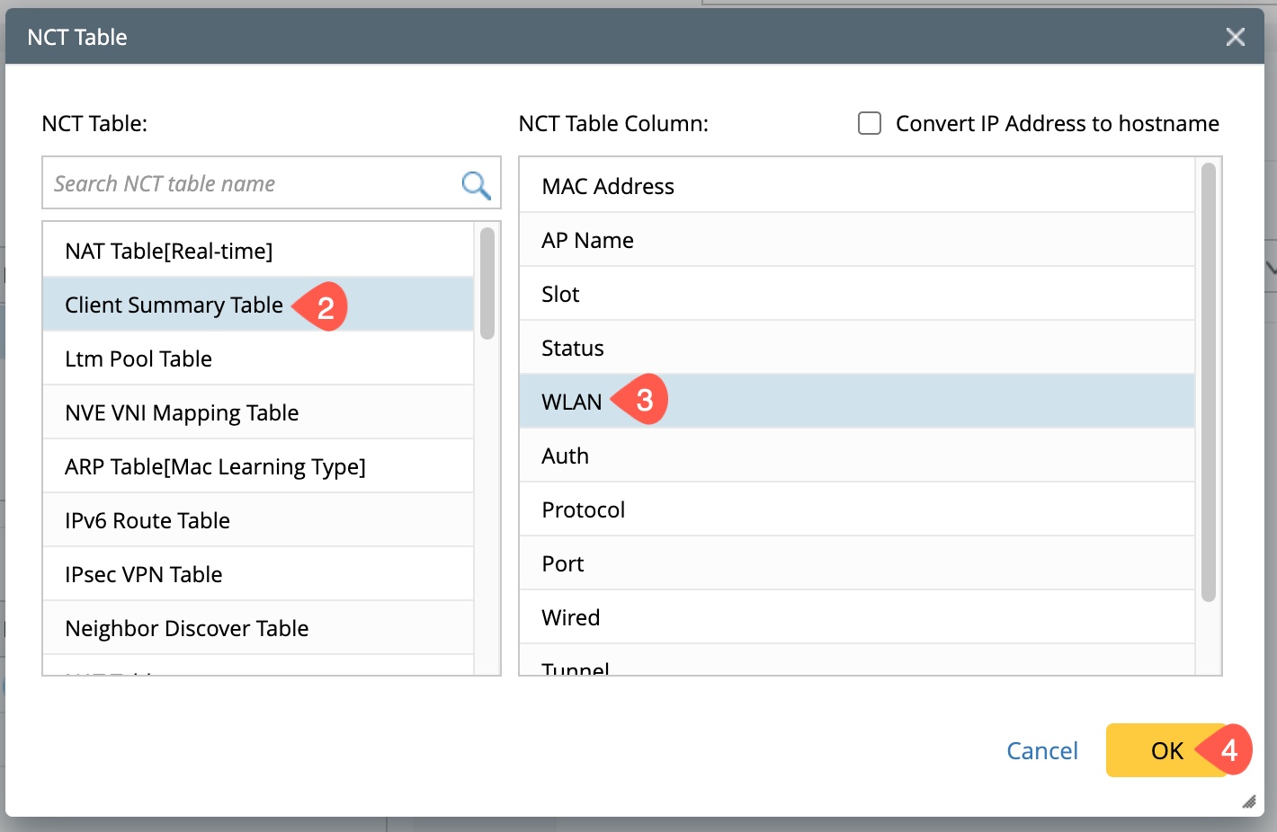

  • Probe Device & Related Device from NCT table:
    1. Click on Select NCT Table to open a pop-up window NCT Table.
    2. Select an NCT Table, and its corresponding columns are listed on the right side of the window.
    3. Select one NCT Table Column from the right-side section. The devices of this column will be added as the member devices of the clone intent.
    4. Click OK to save and close the window.

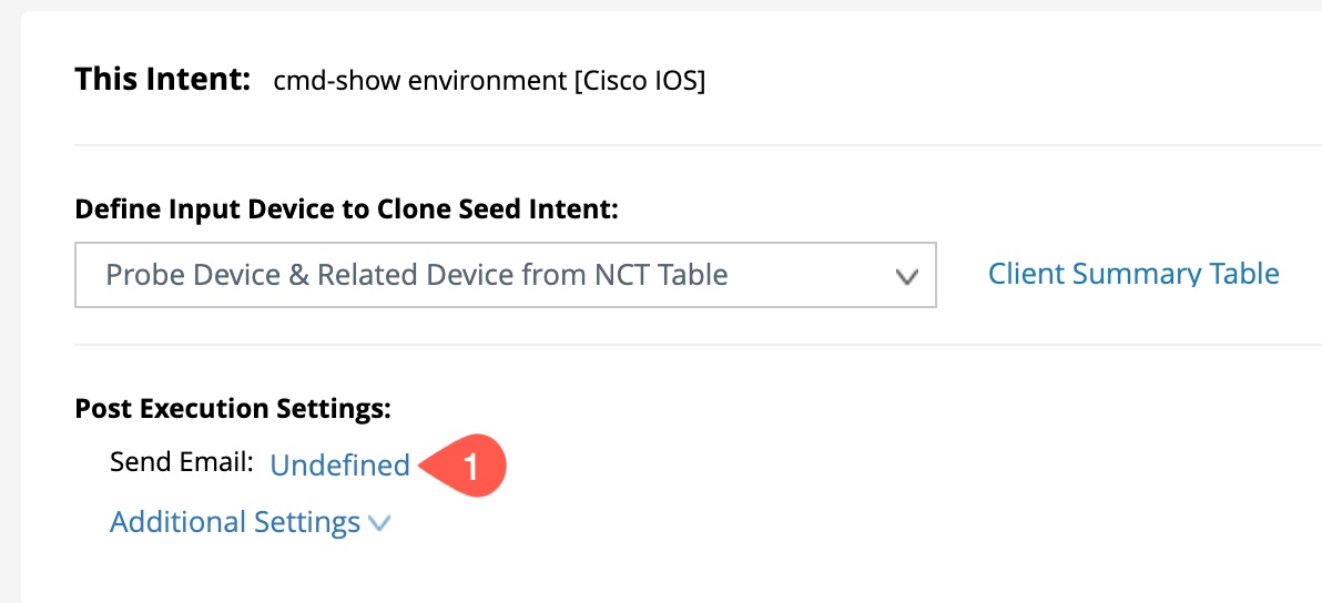

Post Execution settings
You can set up an email alert with a predefined Trigger Event Template whenever the NI has alerts and suppress the triggers to avoid occurring twice within the specified time.

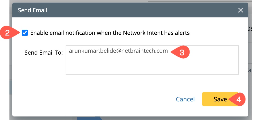

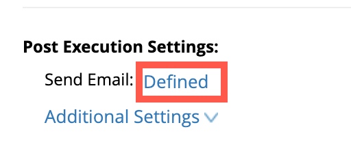

Setting the Email Alert:
  1. Click on Undefined next to Send Email.
  2. Check the box to Enable email notification when the Network Intent has alerts.
  3. Type in all the email addresses separated with a semicolon (;) in the field Send Email To.
  4. Click on Save to save and close the Send Email pop-up window.
  5. Information
    NOTE: Upon enabling the email notification and providing the email address, the status of Send Email will change to Defined.

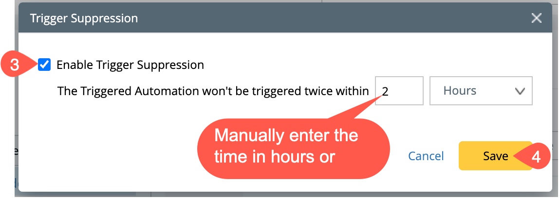

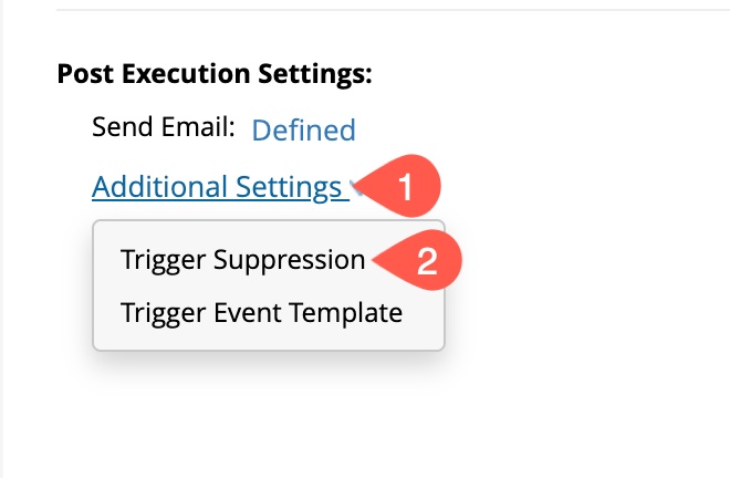

Trigger Suppression:
  1. Click on Additional Settings to open the drop-down menu.
  2. Select Trigger Suppression, and a window Trigger Suppression will pop up.
  3. Check the check box to Enable Trigger Suppression and manually enter the time.
  4. Click Save to save and close the Trigger Suppression window.

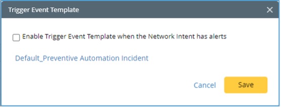

Trigger Event Template:
  1. Click on Additional settings once again to choose Trigger Event Template.
  2. Check in the box to trigger the event Template whenever the NI has alerts.
  3. Click on Save to save and close the window.
  4. By default, an event template Default_Preventive Automation Incident is activated. If you want to choose a different template:
  5. Click on the event template Default_Preventive Automation Incident to open the window Select Event Template with a list of event templates.
  6. If no other templates are available in the list, add the event template from the Go to Event Template Manager to choose a new event template.
  7. Click Save to close the window.
