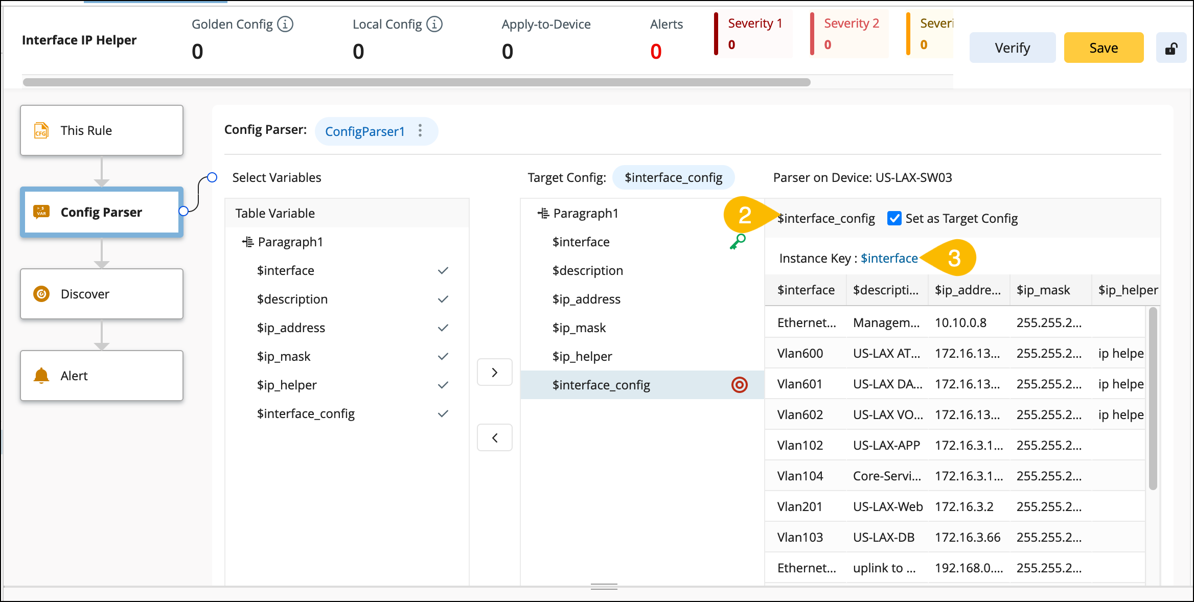

Config Parser
In the Config Parser node, you will add a Config Parser as an integral part and all the single and table variables will be listed in the pane. These variables will be used to:
  • Define Target config: To compare with golden config template.
  • To define compliance/violation message.
  • To filter config instances.
  • To set value for the input variables of golden parameter.

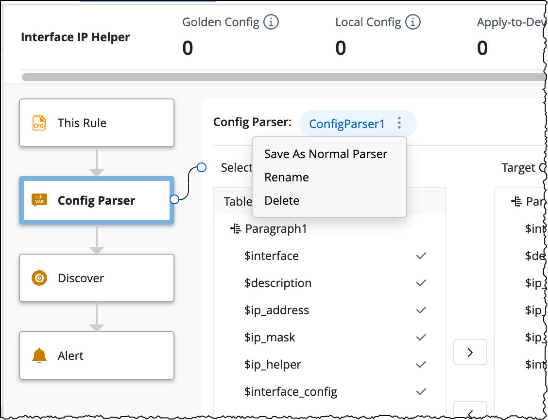

You can add a Config Parser either from the Parser Library or create a New Config Parser as follows:
  1. Click +Add and choose Add from Parser Library or New Config Parser.

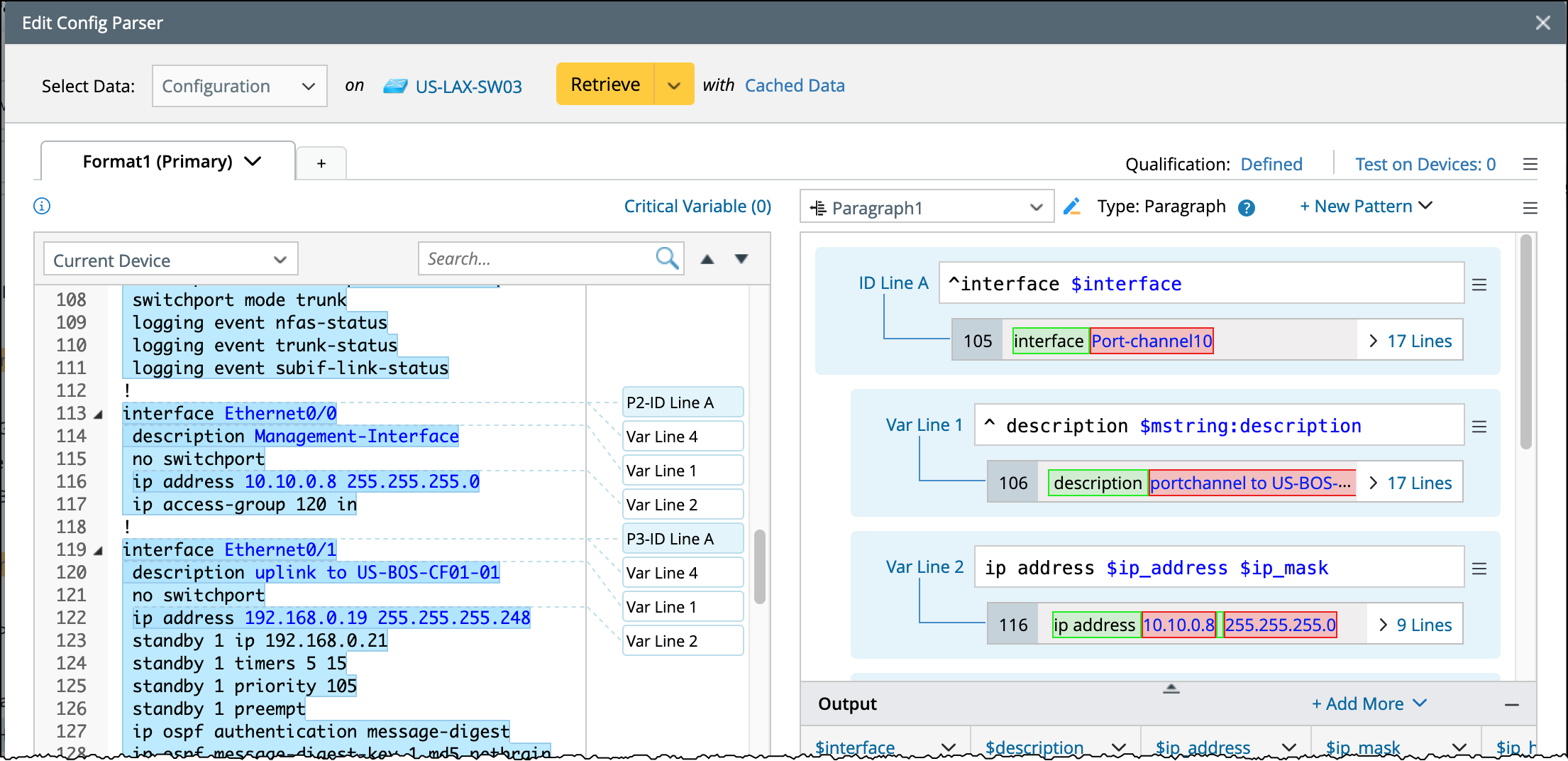

  2. If you want to create a new parser, do it as follows:
    1. Click New Config Parser from the drop down menu to open the visual parser window.
    2. Add a device and click Retrieve with the default Cached Data selection.
    3. Parse the variables from the sample data.
    4. Information
      Note: The Configuration data in the visual parser window cannot be modified and CLI commands cannot be executed.
    5. You can save the newly created Config Parser to the library using the option Save As Normal Parser.
  3. Select one of the variable as Target Config for subsequent Golden Config definition, calculation, and verification. This Variable can either be a single-value variable for device-level config or a table column variable for instance-level config.
  4. Set a unique identifier for the instance information using Instance key. Use a table column variable as the instance key, the target config will have multiple instances.
  5. Information Note: The instance key defines the representation and unique identification of each instance-level configuration. By default, the instance key is inherited from the parser.
